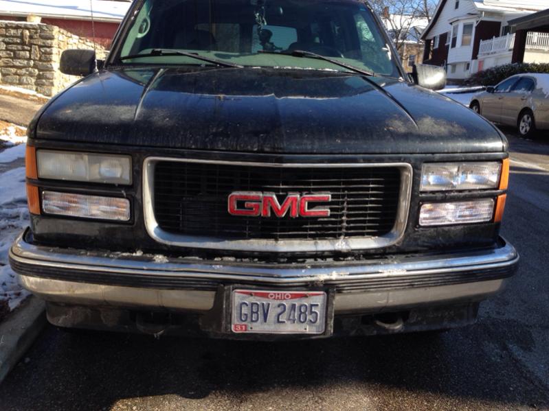

Installed my new lenses today, except one because amazon thought I needed two driver headlights and nothing for the passenger. Had to replace one of the oem mounting brackets and use the junk tyc ones.
