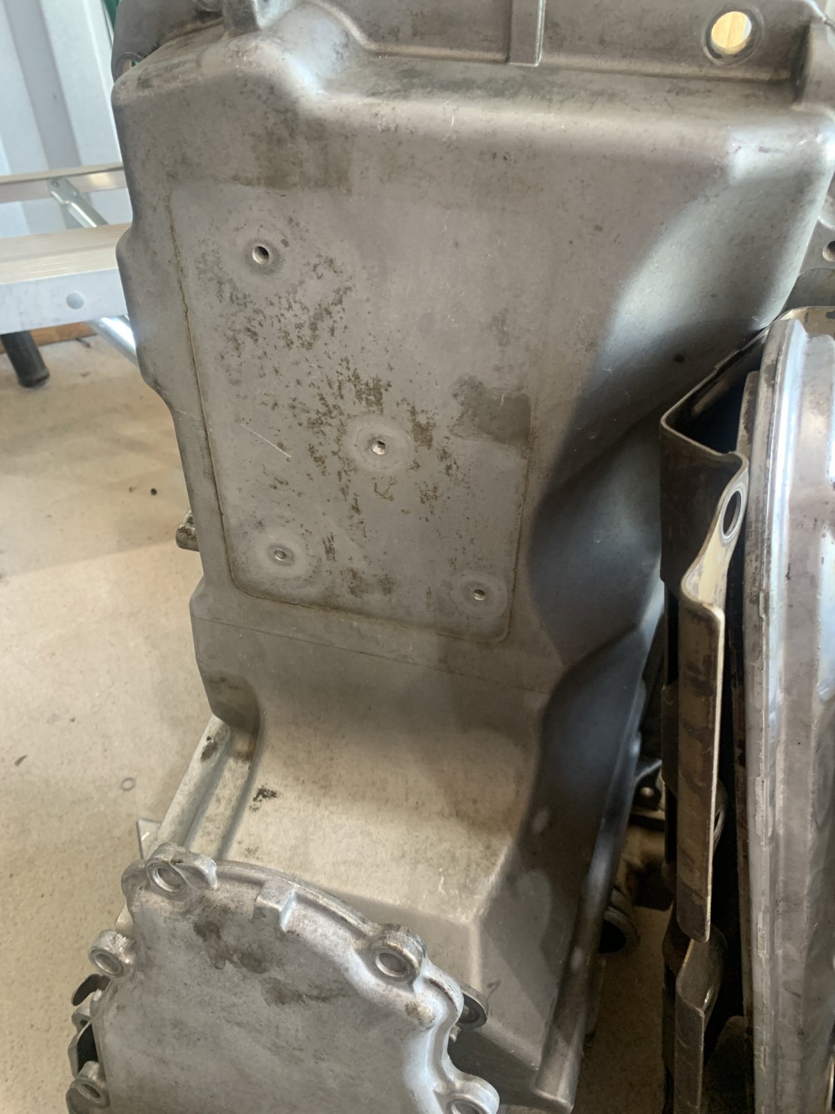

What is this plate on my oil pan???

Just for the record it doesn’t even give you access to anything.... cover plate that covers nothing..

There are vibrations in flat surfaces that lead to metal fatigue, in turn cause cracks to appear. Theory harks back to my aeronautical engineering study days. Change the mass, change the frequency out of danger range.

Yeah, I guarantee it has a purpose. It’s just that no GM engineer has let us know what it is.

I believe it has to do with something along these lines. The oil pan is a structural part of the block and that is a rather wide plane for cast aluminum to carry harmonic loads. Making that part of the pan thicker would've just changed the resonant frequency, maybe even making it more brittle. A simple plate adds strength, but, more importantly, it's bolted at various points so the plane is disrupted and waves are dispersed and absorbed. It's the same effect as how tiling sound absorption mats is as effective or more effective than just covering the entire panel.

I am curious what this plate is on the oil pan of my 5.3L 2008 Suburban LTZ 2WD.
At first I thought it was some kind of inspection plate but from looking at pics of the inside of the oil pan it doesn't appear to have a hole behind it.
So is it some kind of "skid plate" or is it some kind of reinforcement for the cast aluminum pan? Or???
Just kinda curious if anyone knows.
Aluminum is non magnetic. It you live in a cold climate and want to connect a magnetic pan oil warmer then I assume the plate would serve just that purpose.
