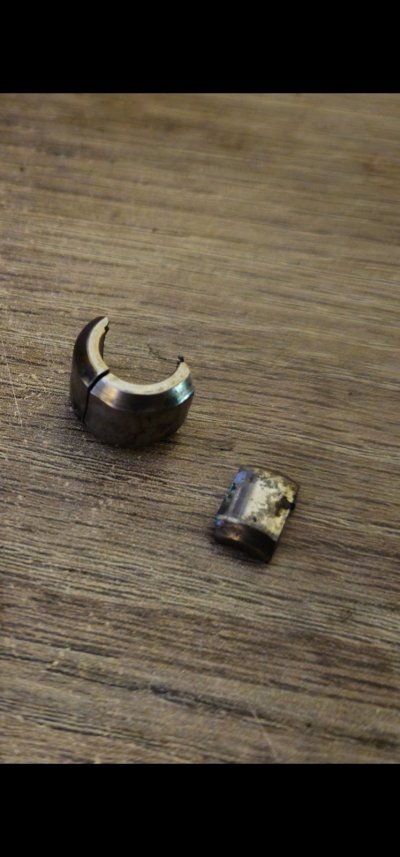

So I took it off and there's nothing but the bottom of the pan. I was hoping for a quick access to the oil pump pickup line bolt but I guess it must be some kind of pointless scrape plate. However.. after dropping the oil pan I found some tings that should have not been there. Check out the pics and see for yourself. Not sure what they came from... any ideas?
