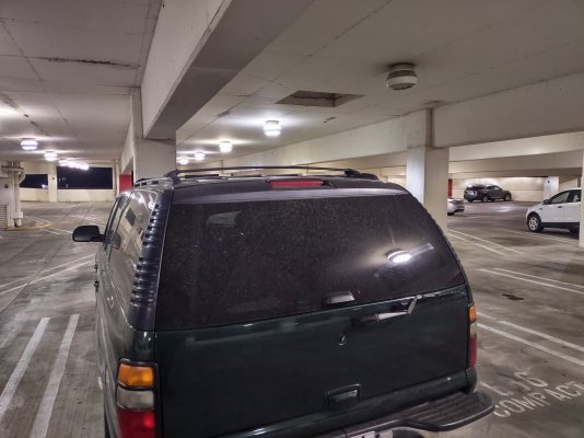

I swapped a 2006 rear glass onto my 2001 after I found the glass delaminating at the top hinge area. I believe this glass was a mid 2005 upgrade, as I've seen it on SOME 2005's, and almost all 2006's have this glass.

The earlier glass has the handle at the lower edge of the window, see pic below. What @ScottyBoy shows (newer glass) is interchangeable with the old style.
