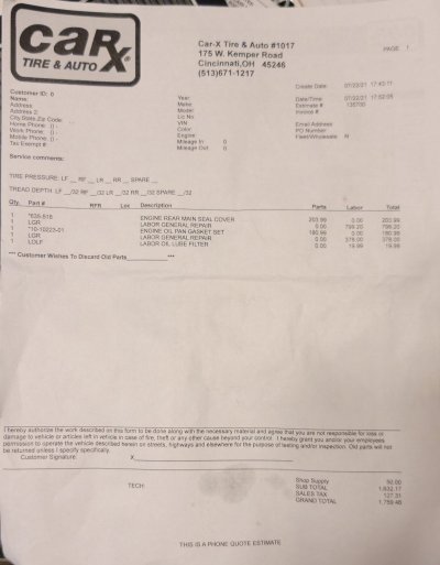

07 Tahoe 4wd and rear main seal is leaking and oil pan. Depending on my driving habits I'm adding two quarts every two weeks.
My dilemma is I can get it repaired at dealer for 2100$ which I think is expensive. Is it? Carx quoted me 1700$ depending on how hard the oil pan is to get to after removing Trans. If not that hard it would be cheaper.
I'm leaning towards carx due to the cheaper price but who would you guys trust with the repairs?
7.1 and 3.5
Shop time is 7.1 hours for the rear main plus parts and 3.5 hours for the oil pan gasket plus parts. So that's 10.6 hours, what are they charging per hour?

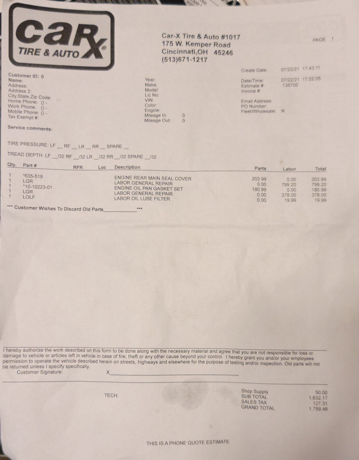

7.1 and 3.5
799.20 labor for rear main seal cover
378.00 for oil pan gasket labor
With parts and tax at carx the total would be 1759.48.
I'd have to call the dealer back Monday as I can't remember exactly. I know it was over 100$/ hr tho and 2200$ total
