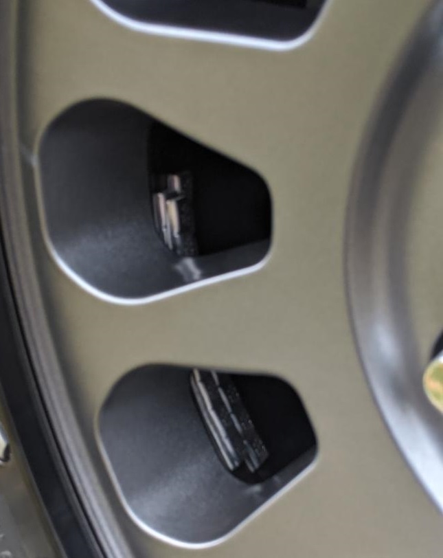

I got these sitting in the truck ready to mount tomorrow....should I tell them to take off the weights and re-balance with stick-ons?
View attachment 231974 View attachment 231975
Personally I'd start by going back and telling them to use the right weight. Wrong clip shape for the profile of the lip
Edit: Also not hammered on all the way
