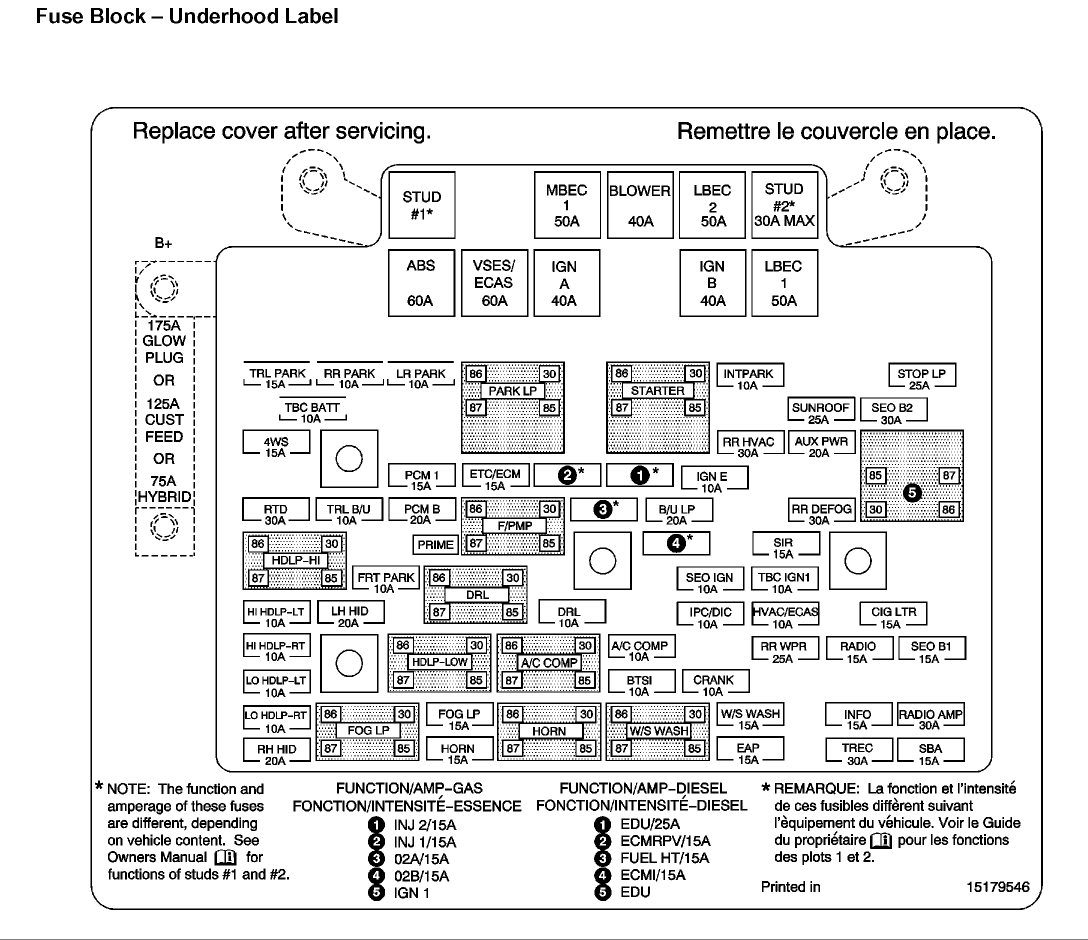

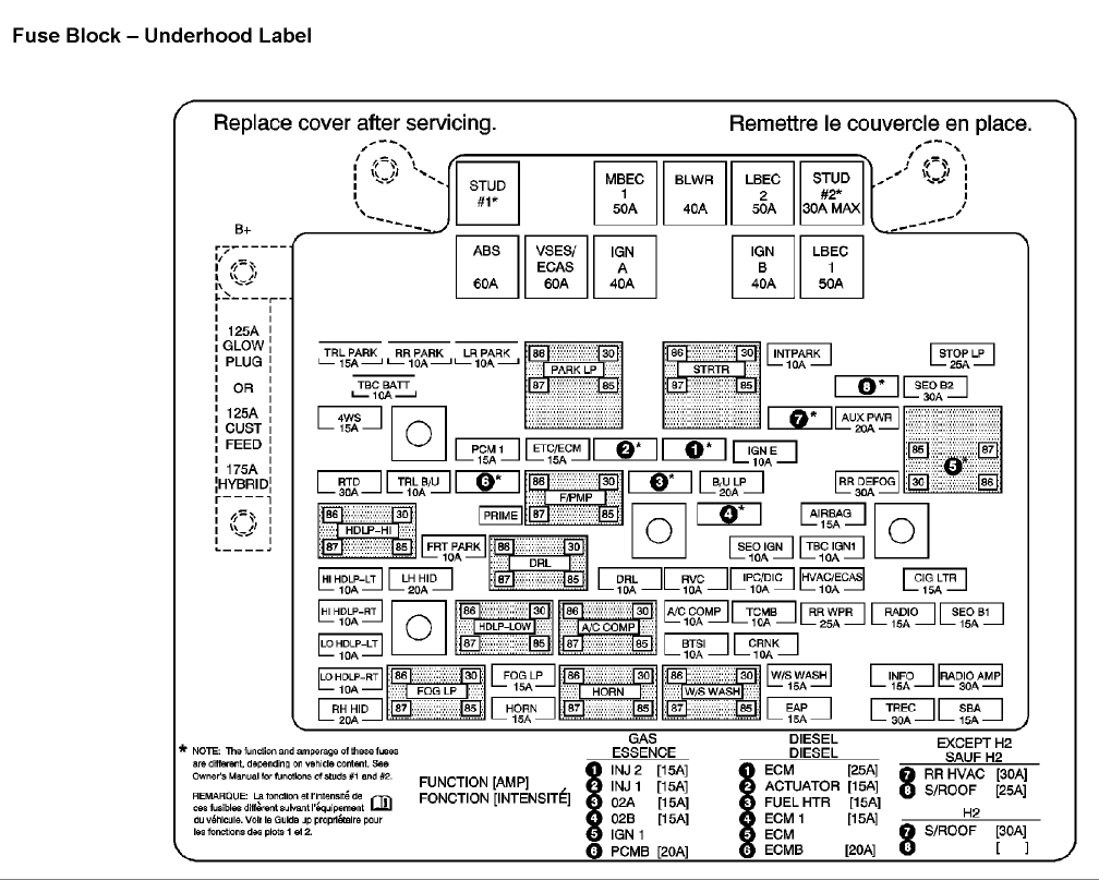

I need your advices.
I just checked the underhood fusebox. I have plenty of empty fuse slots. With the tester I read 12V.
For exemple,
Lower part, right after the relays, I have nothing above CRANK or A/C COMP.
This is a picture from a Silverado 2005 I guess.
The empty slots I have on mine here are tagged TCMB et RVC.
What does it mean ?
If it's strong enough (I need 10A), i could wire from there to my Access GMOS-04 who doesn't deliver permanent 12V.

If I recall, the gmos4 doesn't provide a constant hot, that comes from the harness. It only provides an accessory hot. Which would mean some thing is wrong with your radio harness. I assume you have checked all of your fuses? And if they are good you should have constant 12v coming to the radio module, and can just tap powe from that.
