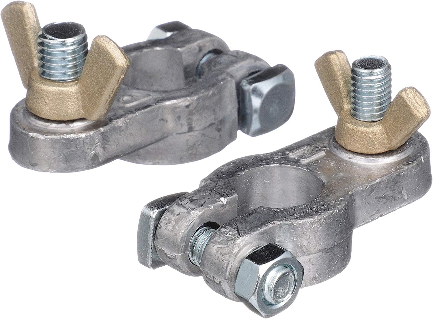

@Matthew Jeschke, as @Alex_M said, a bus bar or distribution block isn't necessary for the ground. The entire frame functions as this. You can convert your side post battery have studs with two different styles- the ones @Scottydoggs showed or these:

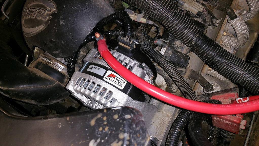

Run one large cable from the battery negative to the frame and one large cable from the frame to the engine. You can have the engine ground at the same point as the battery ground of anywhere else that's convenient. The upgraded charge cable can be one from the battery to the access point in that red plastic box, then the same size from that box to the alternator. Or, leave the factory stuff as-is and just run one large cable from the alternator to the battery positive.

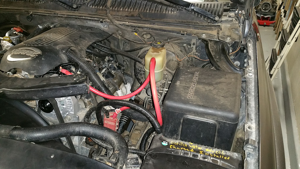

Here's my shizz:
If you have an RVC sensor and if your new alternator is compatible, run your ground through the sensor. I re-did my stuff later to have the one ground cable and had it passing through the sensor:
In the pics in that link, you can see I have three cables on the battery. The ground, the charge cable from the alternator and the upgraded cable to the starter.

I should've specified, but thought the pics would show. Mine's an '08 (GMT900/NNBS), which doesn't have that red BAT+ connection and the battery is in the rear passenger corner of the engine bay. My point was showing the necessary circuits and terminations, not specifically the routing and locations on your model.
Grounds should be as short as possible. There's a bolt in the block for the power steering pump bracket and a strut mount stud and nut is very near that. Yours doesn't have struts but the idea is to find something on the frame that's near a threaded boss or existing bolt on the engine block. A flat piece of the frame (or a cross member) that's accessible to both sides would be great since you could drill a hole and bolt the cable to it. I haven't memorized the GMT800 frame to this degree or I'd have a less vague answer. The universal kits are made a bit long with the intention for you to trim as needed.

The lugs are the same for top or side mounted posts. You don't need a new battery, you need "extended battery terminals".
DO NOT try to fit several larger 1/0 size wires into one lug/splice them together. With the extended terminals, you just stack the lugs.

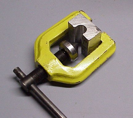

You can get large cable ends at an electrical supply house, auto parts stores, etc.
Here's how I attach them when I make a battery cable using a flaring tool and a block of aluminum. I drilled a hole in the aluminum to fit the diameter of the terminal, then sawed it in half.
