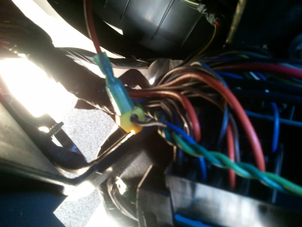

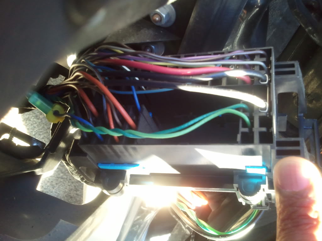

Thats not true I know how to make the radio stay on until you open the door. There is a panel on the passenger side like the fuse panel on the driver side. There is a wire in there that you can tap into.
Sidenote: You will lose all warning chimes though, but thats what the dash lights are for imo.
