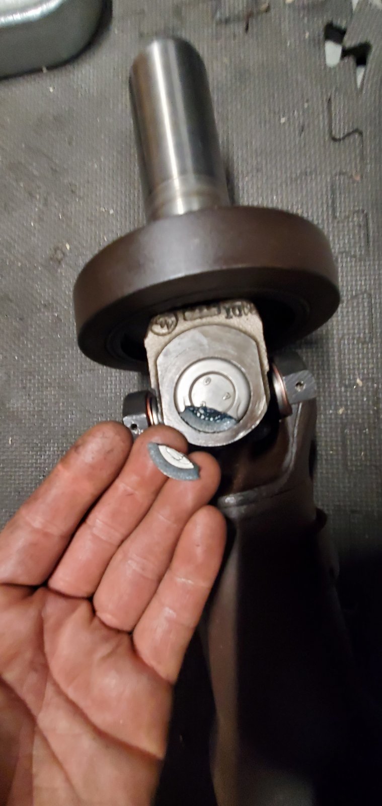

did someone try and press the cap on with one of the needles down there? odd part to just break, unless you ran something over i guess

A picture is worth a thousand words but a detailed description of how it happened would really help. C'mon man!

Funny you should say that.
Here's the story..
I had these nice new u-joints laying around for months, just never had the time. So I decided on a Friday night before a major camping trip with my brother and nephews, that it would be a capital idea to finally get those factory joints out. After hours, HOURS, of wailing on it (using the socket and hammer technique), it wasn't budging. So my brother comes over with the correct tool, and boom, within 30 minutes had the new ones in except for the last cap...
In my fatigued state (yeah that's what I'm going with) I couldn't quite get enough clearance for the snap ring to seat correctly and I cranked the press the to the point that it pushed the, body I guess(?), of the u-joint into the top of the cap and alacazam! The results of my entire night of hard work are pictured above.
Threw my hands up and reached for the jb Weld, then went to bed feeling like less than a man. Worked great until probably mile 105 of my trip, going around 60mph, the teeth chattering vibration started. Didn't check it until I got home, because nothing I could do anyways, and you could probably have guessed that there wasn't one needle left inside.
