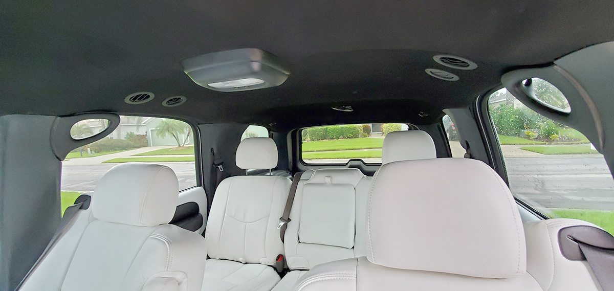

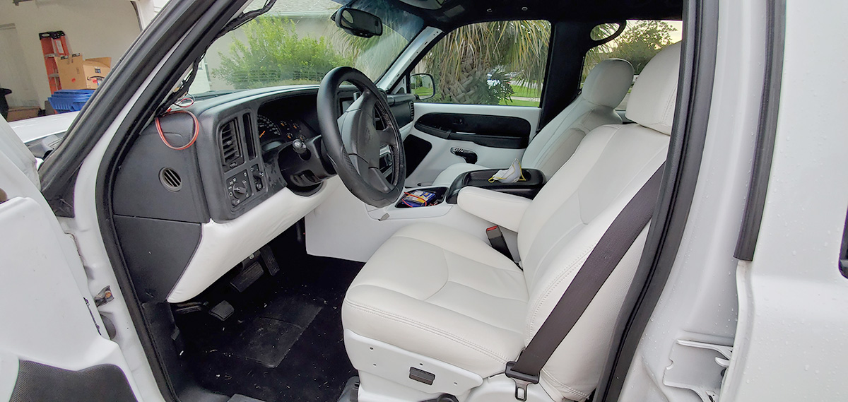

Just a thought and you build your ride your way. Have you thought about some black seat belts to make your white seats look more white? I see that you have the grey dash and it matches the seat belts but a little black wouldn’t hurt in my opinion. What your doing looks awesome. Keep it up. Your ride may inspire someone else to do something cool.

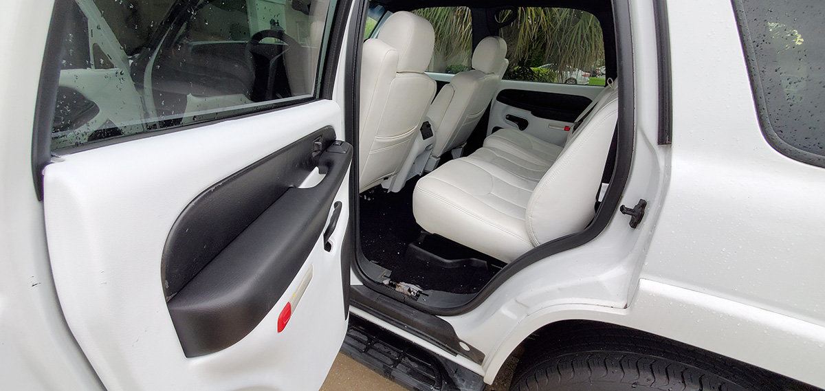

What white paint did you use for the leather and the plastic?
I used duplicolor vinyl paint. Black and white. You gotta prep the heck out of the plastic for it to stick, but it works great with just cleaning and grey Scotchbrite pads for rubber (like the doors) and leather. Just soaks right in.
Funny you mention. Those are actually the blackest ones I could find and they came out of a Hummer H2. I couldnt find actual black belts that also worked with the airbags (yep, the 2003s have seatbelt pre-tensioners that fire with the airbag.) I didnt want to spray them black because I was worried about it rubbing off on the white. So I had to cut the Delphi pretensioner out of the passenger seat and resew it into the H2 seat belt. The mechanism that allows the belt to go inside of the chair is the same. It was a bear getting those bolts to come out after 17 years of rust and blue loctite, but I did it.
I also have a black dash skin that I used and the dark charcoal is really close in color.
Believe me, I looked for black, but this was it.
I do have actual black belts for the passenger rows as they dont have sensors or come up thru the seats.
Thoughts?
