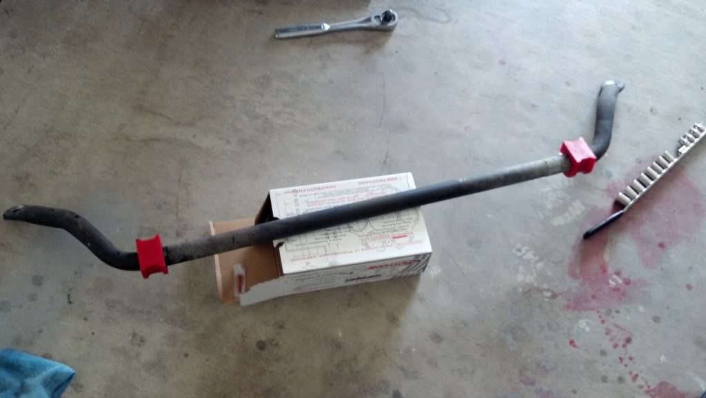

Hey guys trying to re do my front and rear sway bar bushings and end links. I can't find anywhere online what size the front and rear bars are. I want to make sure I get the right bushings the first time. Its a 2006 denali air ride awd with stock 20's. Thanks.

If you go on Rockauto there's a few different sizes to pick from.... I ended up going with the 1 5/16ths hopefully they fit.

Bump. Ordered by year and model from rockauto. Nope didn't fit.

It's not hard. Just put a dial caliper on the sway bar. If you don't have a set of calipers, just find an open end wrench that just fits around the bar.
