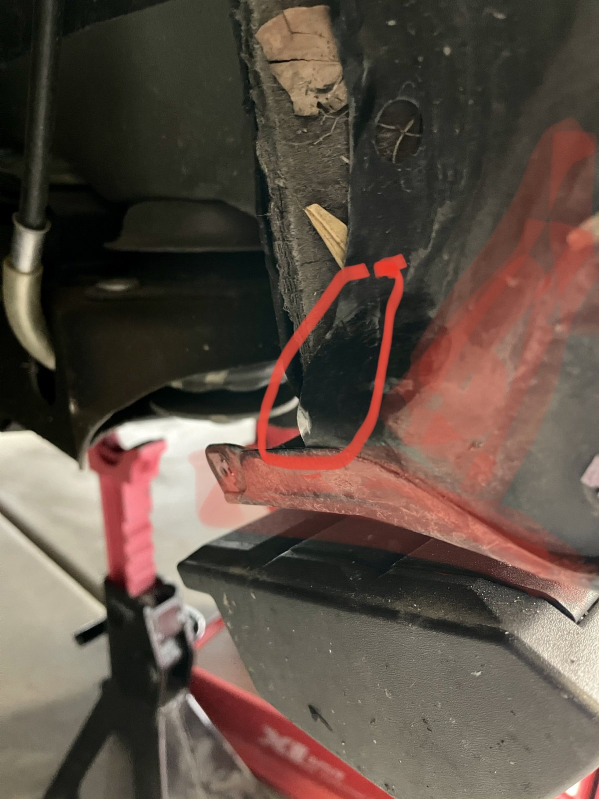

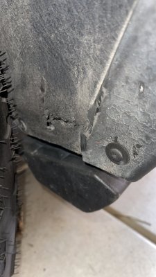

I finally got a chance to peel back the wheel liner and found the culprit to the rubbing. I was able to bang/massage the metal back on the lower fender for both sides. Still rubs the wheel liner when fully locked but I’m ok with it. My level kit comes on Monday, I’m hoping that will finally take car of all rubbing. I also trimmed the plastic piece on the bottom as well. When I install my level kit, I might bang on the drivers side a bit more. I was a little hesitant the first time around. Here’s some pics for reference.

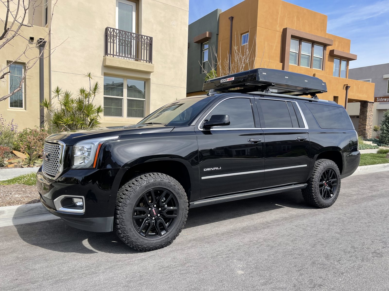

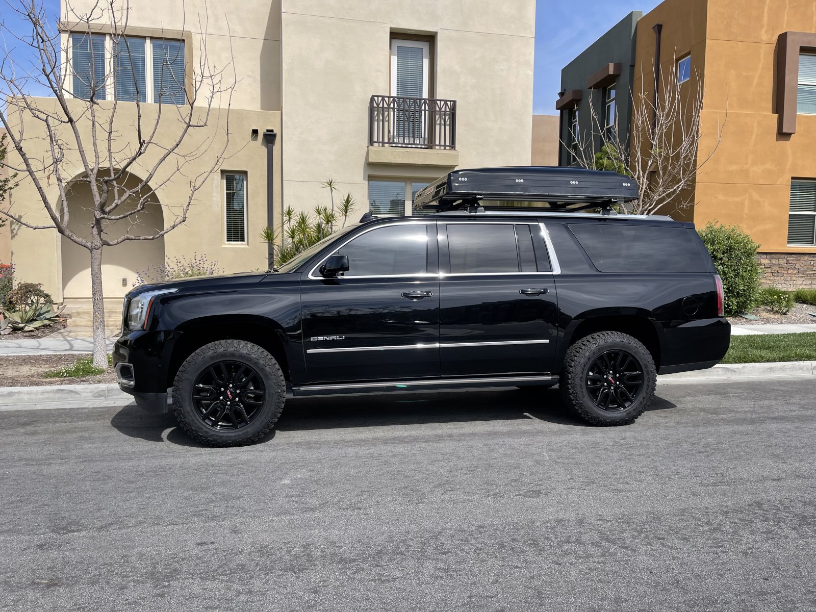

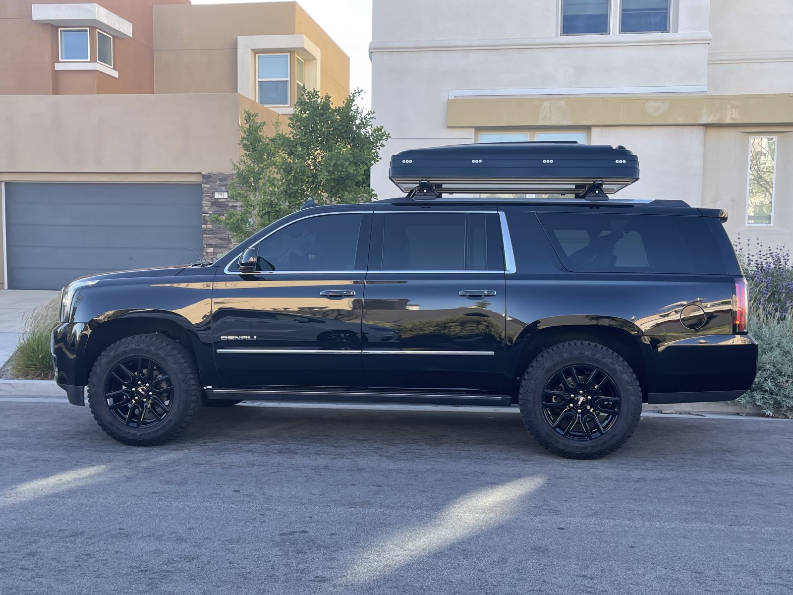

Added 2.5” level kit in the front and will be adding a 1” level for the rear this weekend. I no longer have any rubbing issues.
