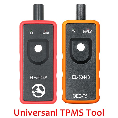

You need another set of TPMS sensors...it is basically swap and go, assuming you follow the TPMS Sensor Matching Process -- Auto Learn Function from the Owner's Manual. I have never actually done this, as my tire shop always handles for me when I swap them.

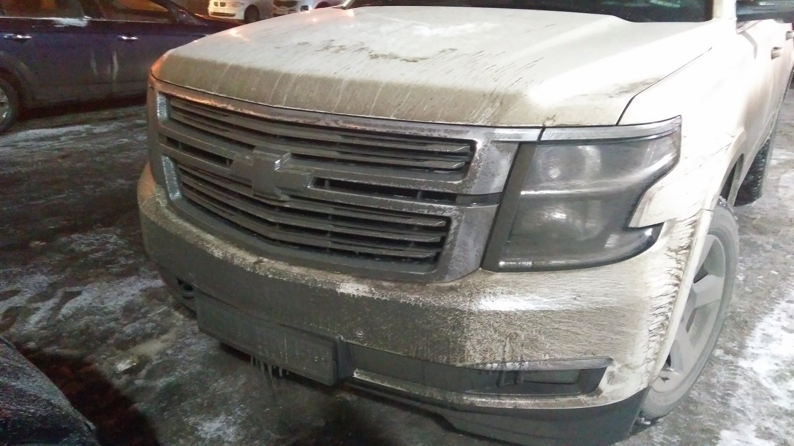

Vladimir2306
May 18, 2023
502
498
Yes, I looked up the Minnesota climate. Very similar to ours))) But I prefer studded tires. Powerful, toothy, because there is often a transition through 0 temperatures, and there is ice on the roads)
I've had great luck w/ Blizzaks here in Minnesota...They do have a bit more road noise than the stock Alenza's, but hardly notice it. Winter temps here range from -20F (-28C) to about 30F (-1C), with most of January never seeing above 20F (-7C). Traction and Performance much improved over all seasons. They will be going on in about a month, and coming off about April 1.
