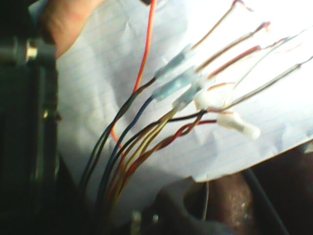

Im not sure what this is right here. i just notice the speaker wire a tied to it.

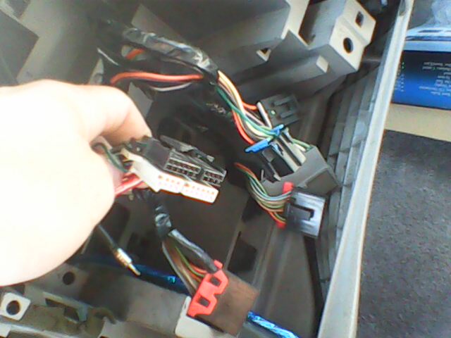

this looks like its in good condition..

those are stock radio coonects in your hand and below except for that long gray one and at least the one above that are hvac stuff. if you have rear defroster you should have three hvac connectors total. the black plus with the red locks on them inter connects the radio unit with a seperate audio player unit. depends on your config if the seperate unit is a cassette or cd unit. black coaxial line with pin is radio antenna. as for the top picture that was someone splicing into speaker lines probably. would need better pictures to decipher color coding.

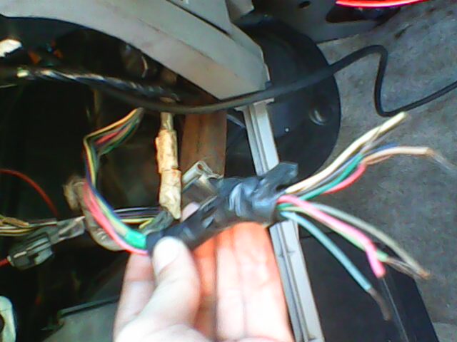

here is a little better picture of the wiring ( i added the paper so you can see kind of see the colors better.)

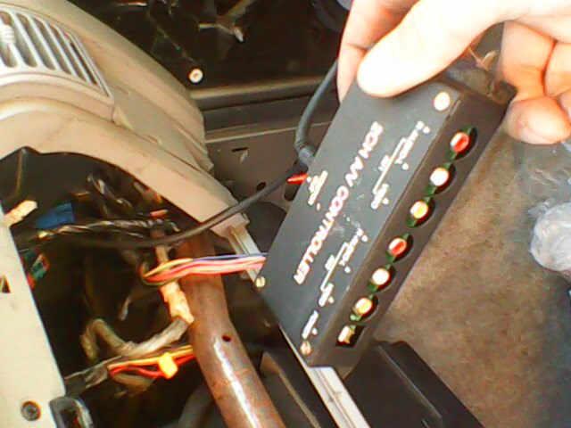

Also i have these cut cords coming out of my glove box area.. i have no idea what they are for.

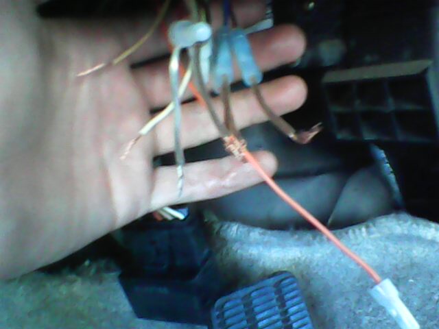

im guessing this is for more add-ons or something but this is also connected to something behind the glove box.

that first pic is staring to look like the hvac blower resistor wiring. can you track where those bundles go and get tome very clear pics of them. i can get you the diagrams you need for repairs but i need to know where those bundles end up as best as you can also need year and trim type of vehicle. i can see a bit better but could use more clarity.
