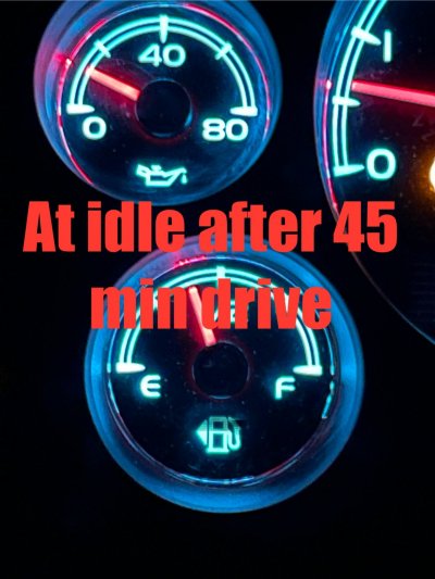

Not much has changed. Never got the o-ring fixed, mechanic told me that the job was quite involved and would cost on work hours, so decided not to proceed.
Oil and filter was changed (again,again,again) oil pressure at startup has improved and has been unchanged for a month now. Oil pressure when driving on the highway sits at 40 psi (around 1400rpm’s). Once engine is warm and at idle pressure drops on the gauge. Once I get moving it immediately increases.
The actual reading of the oil pressure, which the mechanic did with his equipment said pressure was 20 psi at idle when warm, so the gauge is not showing the actual pressure.
Noise at start up is still there, but goes away. On warmer days goes away faster, colder days it takes a little bit longer.
I bought the exhaust manifold clamp, but was unsuccessful with installation, there’s literally no space getting that thing on the back of the engine driver side. Next time I’m going for an oil change I’ll ask the mechanic if they can put the exhaust manifold clamp on.

Those are perfectly normal numbers - very similar to mine on both trucks except that my hot idle is a little closer to the 20 mark.

Thank you for your input, it’s nice to hear other seeing similar readings. the mechanic also said that the oil pressure was normal and within spec even though the gauge shows oil pressure at idle a bit on the lower side

That O-ring has been talked about in great lengths about how it is one of the major sources of low oil pressure woes. I'd replace it before thinking about focusing on anything else! Oil pan has to come out, that gives you a chance to clean out the engine oil pan and sump as well. Especially seeing that you're approaching 181,000 miles. It's a no brainer to do if you're concerned about oil pressure, and secondly, the oil pressure sensor if you're wary that the gauge is not reading close enough to the mechanical test gauge that your mechanic used. Both are important.

I was also pretty confident that I would like to have it replaced, but since mechanic said that oil pressure was normal at idle he said that I probably shouldn’t be concerned about the o-ring. I’m not sure how involved dropping the oil pan is. In the YouTube videos it seems like a job that takes a couple of hours, but my mechanic said it would take a couple of days to get to it and have it put back together, because so many things had to be removed.

Seems like the crossmember and maybe the differential need to come out, not a days long job, few hours maybe? Not sure why he would be exaggerating.
