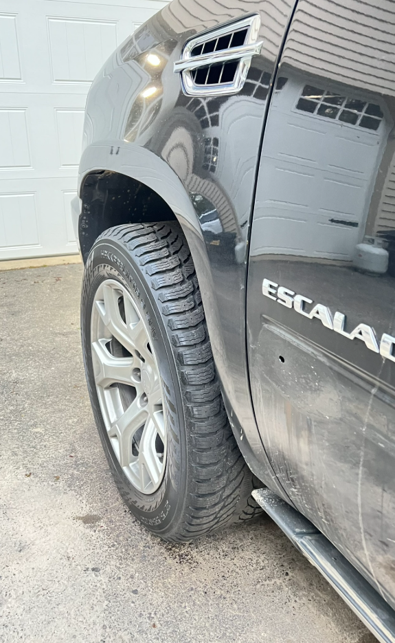

Dirty as crap but now with TGC 2.5 and bilsteins on the first notch.

How much room between your uca and droop stops? How about upper ball joint angle? Set on the .5" setting? I have the bilsteins in the plans and wondering if I need to order uca' s too. Mine with a 2" lower spacer leaves me with about 1/4" before droop.

UCAs are probably not a bad idea. I'm not happy with my angles but they're not that much worse than they were with just the level. With +150k on the clock, I would've needed UCAs pretty soon anyway. I've got around 1/4" to the droop stop. Drove it about 50 miles today and didn't hit the droops anywhere including old 2-lane roads, gravel roads all the way up to highways.
