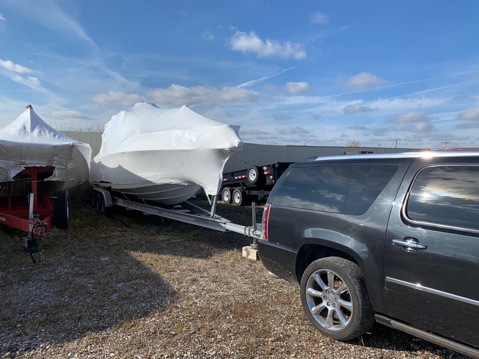

I towed 12k boat and trailer 50 miles......Your RV may be 6000 lb all in. Your rated to tow that.
