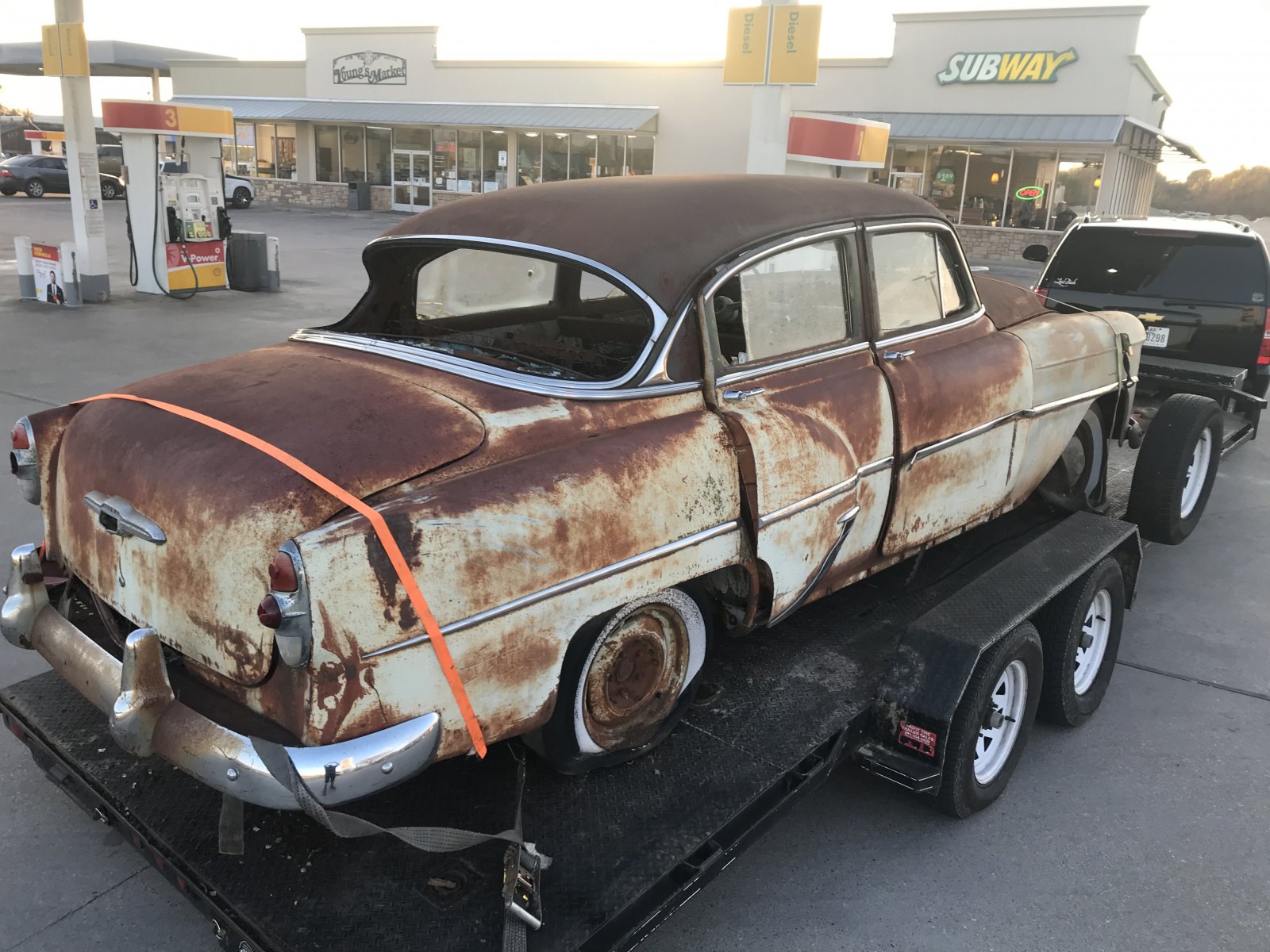

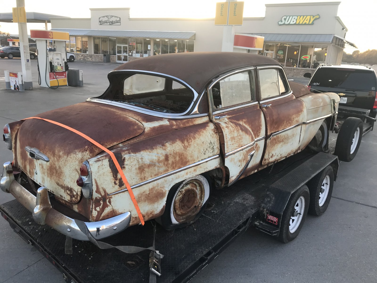

Main upgrade I will tell anyone towing over 4k frequently upgrade the rear sway bar, stock z71 is a big upgrade over the stock plush one, bigger rear bar keeps the truck way more stable. I have pulled 8k with a 03 tahoe 4.8 through some major hell, she reved but did it like a champ, had 10k on my burb, not great but keep gear in about 4th gear max when heavy with tow haul on and let her eat, good cruise rpm about 2800 and your in the power band real nice, get better mpg there also. I'm upgrading the rear bar in mine soon, just needs it when I have a car on the back for sure.
Your travel trailer will be fine if the weight is about 5 to 6k, I know some old ones were about 7 to 8 and that's pushing things when you add gear water etc. Plus side about pulling travel trailer with these is the wind you cut off the trailer with your big vehicle actually helps towing more than with a pickup.
