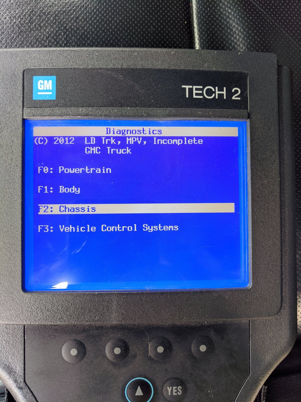

it's in there I think under "body" vehicle needs to be unloaded and parked sitting level, I just ran the tech2 cable out the drivers window

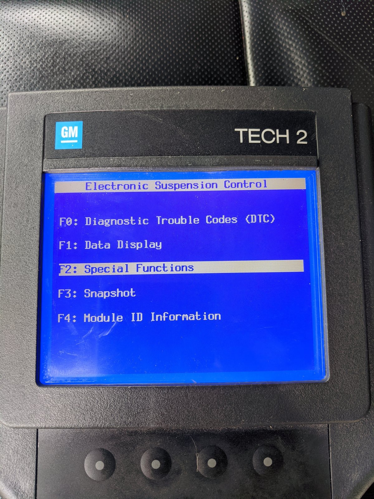

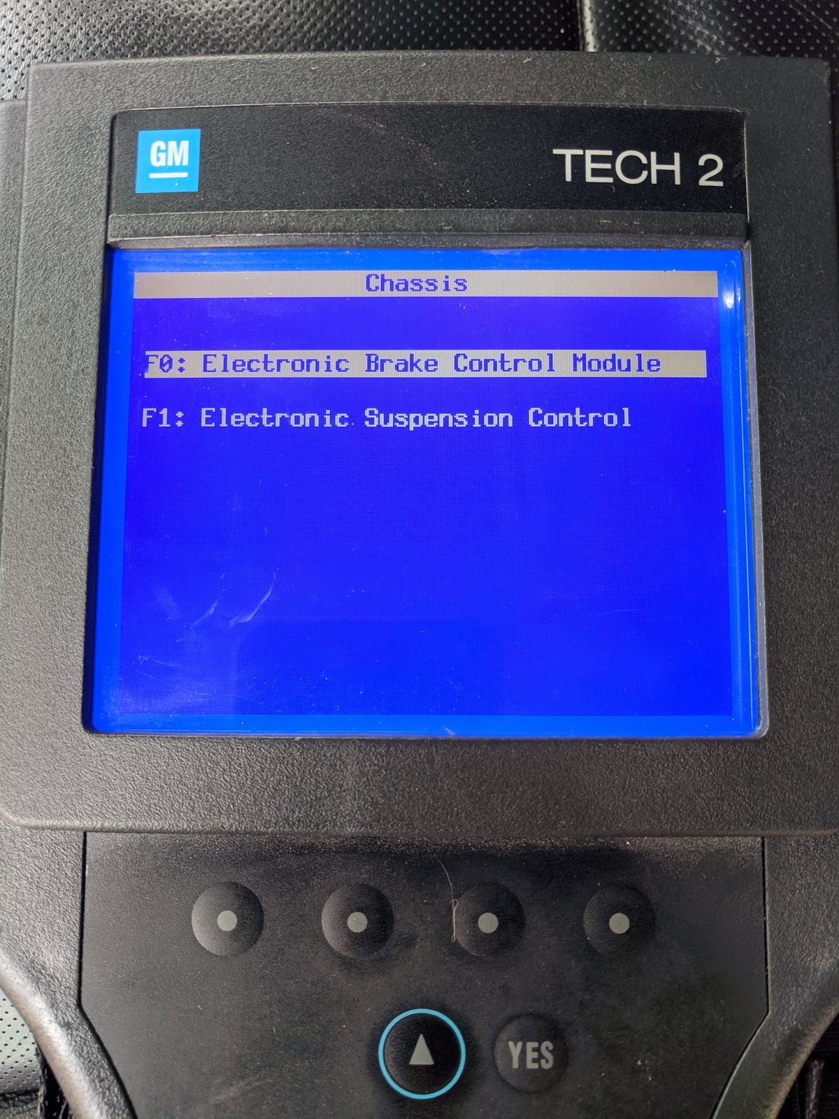

It's under the chassis part, then special functions.

@Doubeleive
I don't get that option on my Tech 2, I tried the body and chassis and can't find anything about the suspension.
