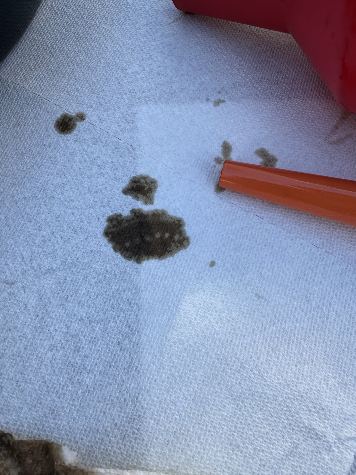

Had a nice warm day this weekend, so I did a quick drain and fill on my transmission. I used an oil extractor and it worked like a charm. No mess.
I’m really glad I did, because my transmission oil is pretty worn, and I’m pretty sure it has never been changed. I only replaced 5qts for now, and then I’ll replace another 5qts once I drop the pan to replace the filter.
So far, the transmission seems a bit smoother - I’m going to order the filter and gasket so I can be ready for the next warm day off.

when we were shopping around for one earlier this year almost all of them had brown/black fluid.....
people just don't care i guess

Where did you extract the fluid from? Did you pull the fill plug by the exhaust heat shield (the place where a dipstick SHOULD be)? I'm assuming you just put in 1 for 1? Did you check the level with trans pan bolt after it was warm?
Just wondering because I've never done an 8 speed myself......yet. After the last stealership idiot that did it and left it low, I plan on doing this myself from now on.

I assumed that based in the year, but could be wrong (?). I thought OP stated he had the 8 speed. I was wondering about the process since there is no dipstick on the 8 speed.

No I’ve got the 6L80 6-speed.
I extracted the fluid via the transmission dip stick/fill tube - it was a super easy process. Then I measured what I took out, and filled it back up with the same amount and checked the level after a drive.
I’m also going to do another drain and fill when I drop the pan to replace the filter.
