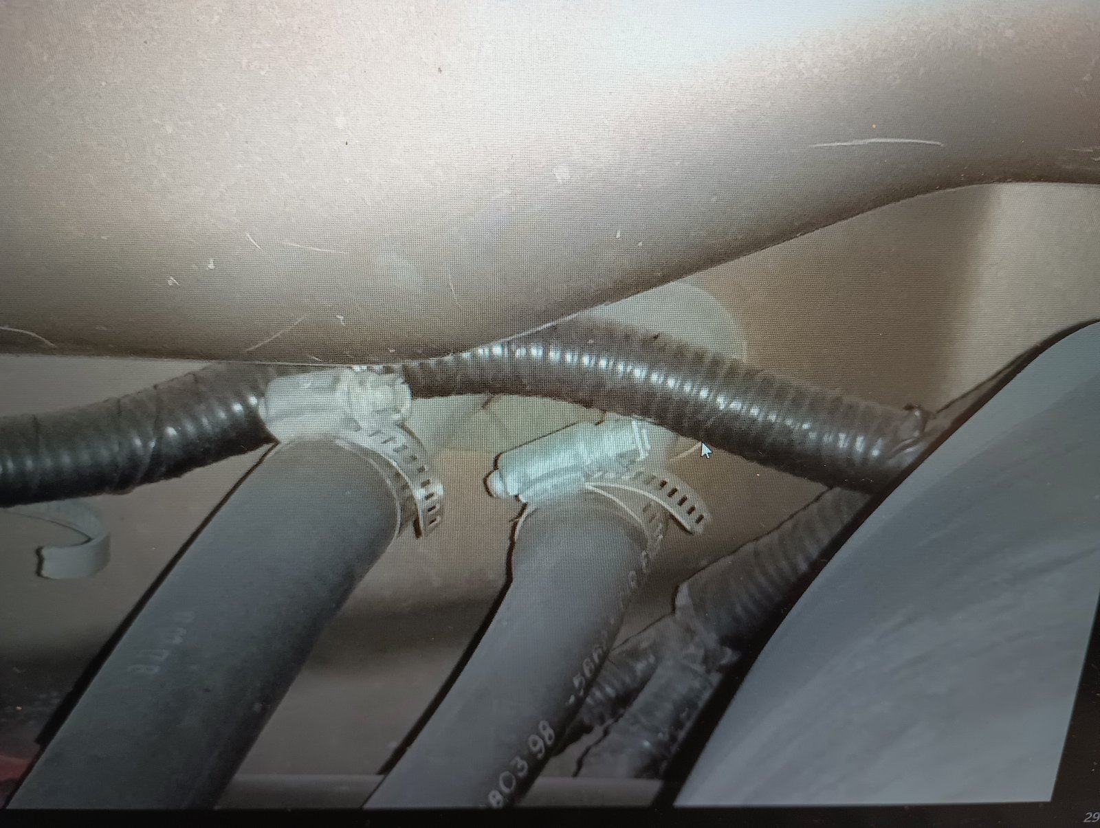

Here's my 1999 Silverado. When I had just bought it in like 2008 one of those plastic quick connects broke. I just removed the hoses and connected them directly into the aluminum tube with hose clamps. Back then I didn't even know they sold quick connect replacements.
What I actually did first was removed the hoses and bought a brass coupling from the hardware store (I think it's 1/2" or 5/8") just to get the truck running again. It was in the summer and I was in college and no tools. When I went home to my Parents' I just broke off the plastic and hooked them up directly as shown. I think I still have the coupling in my glovebox.
