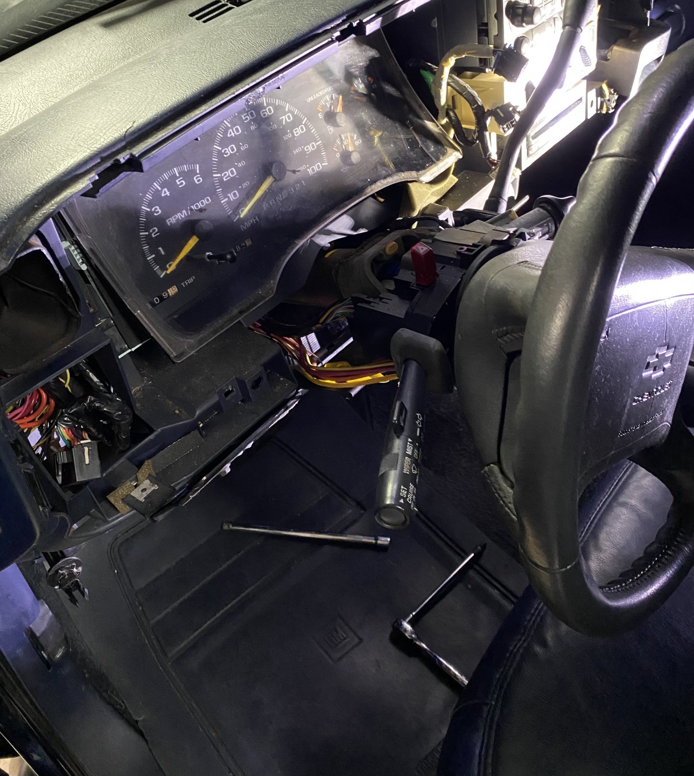

Multifunction Switch Ebay
Found these on eBay for $40 vs $100 from big box auto parts places. Any reason to be concerned using one of these? From what I can tell the pins line up exactly and the part looks the exact same. I would definitely plug it up first and give it a test run before assembling everything
