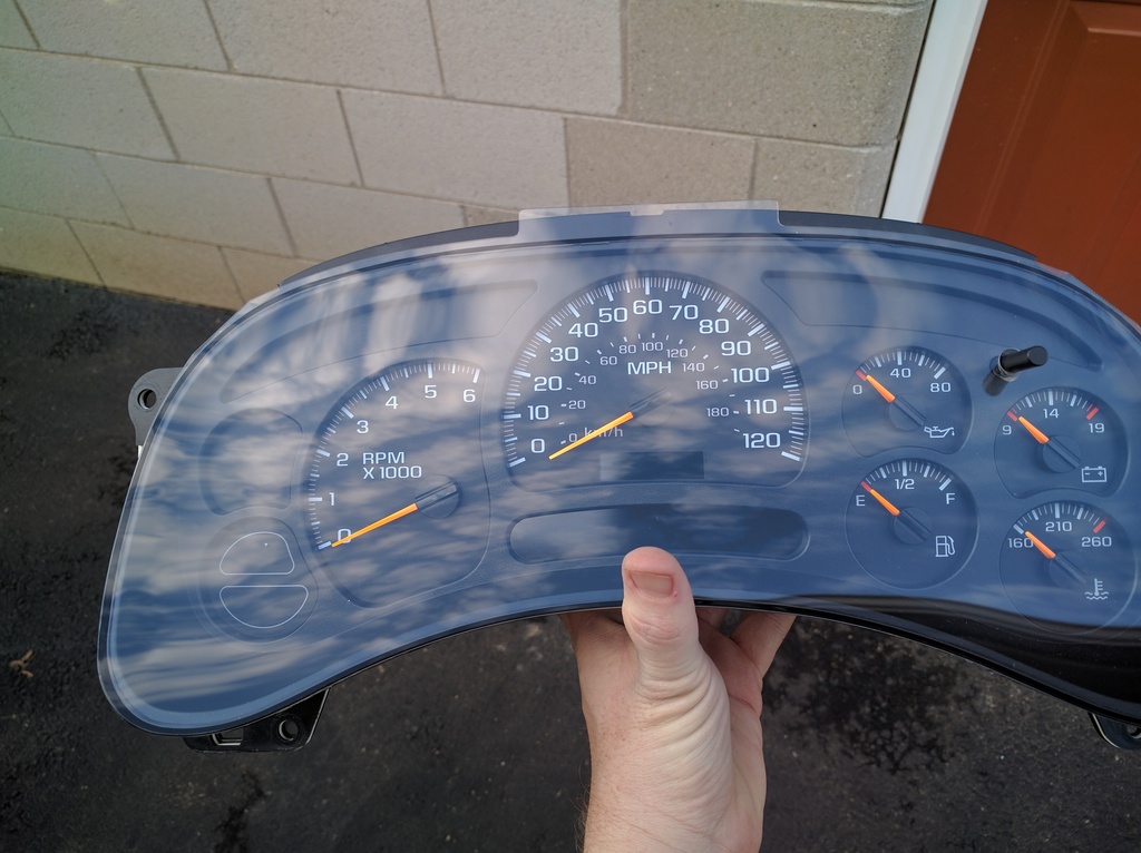

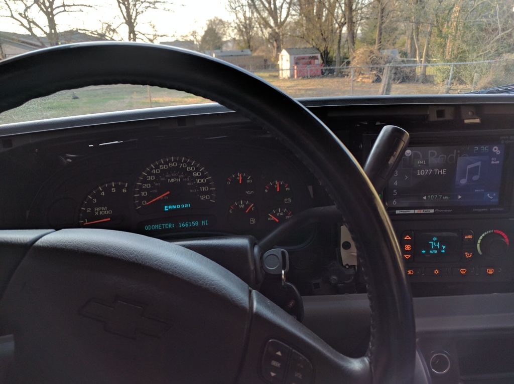

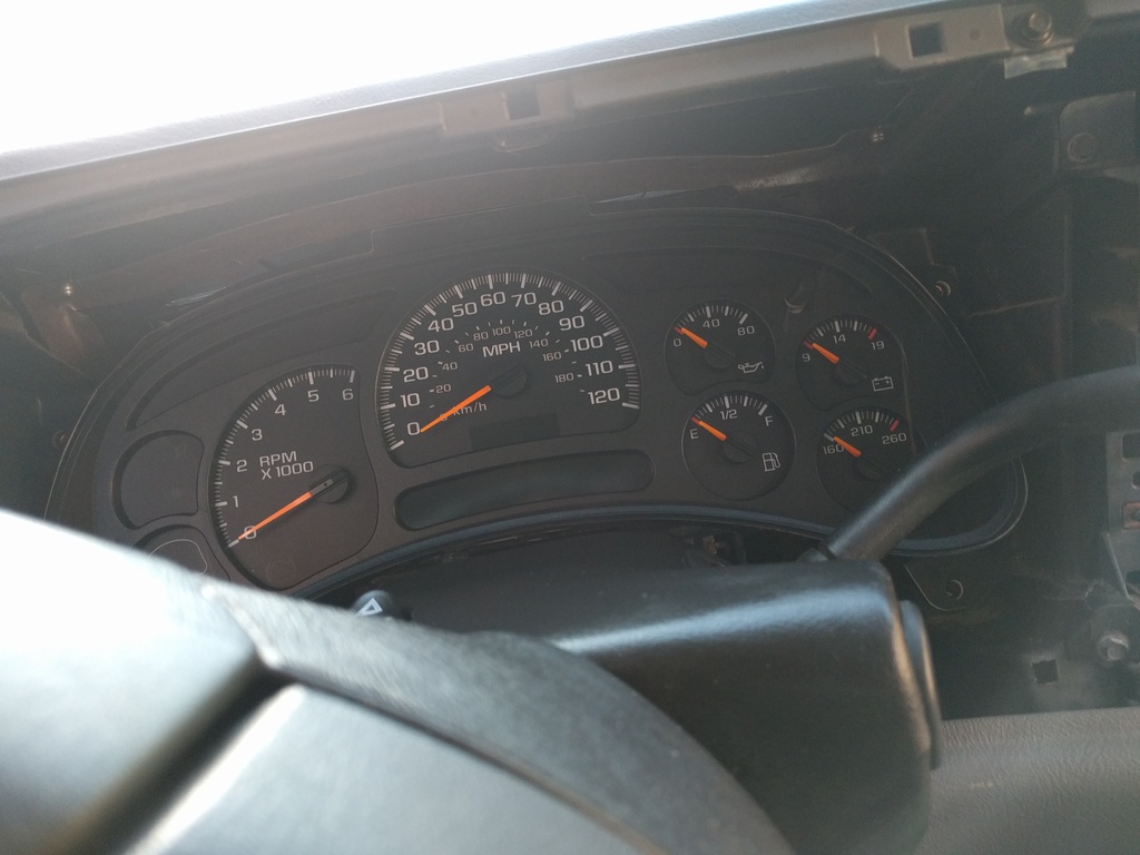

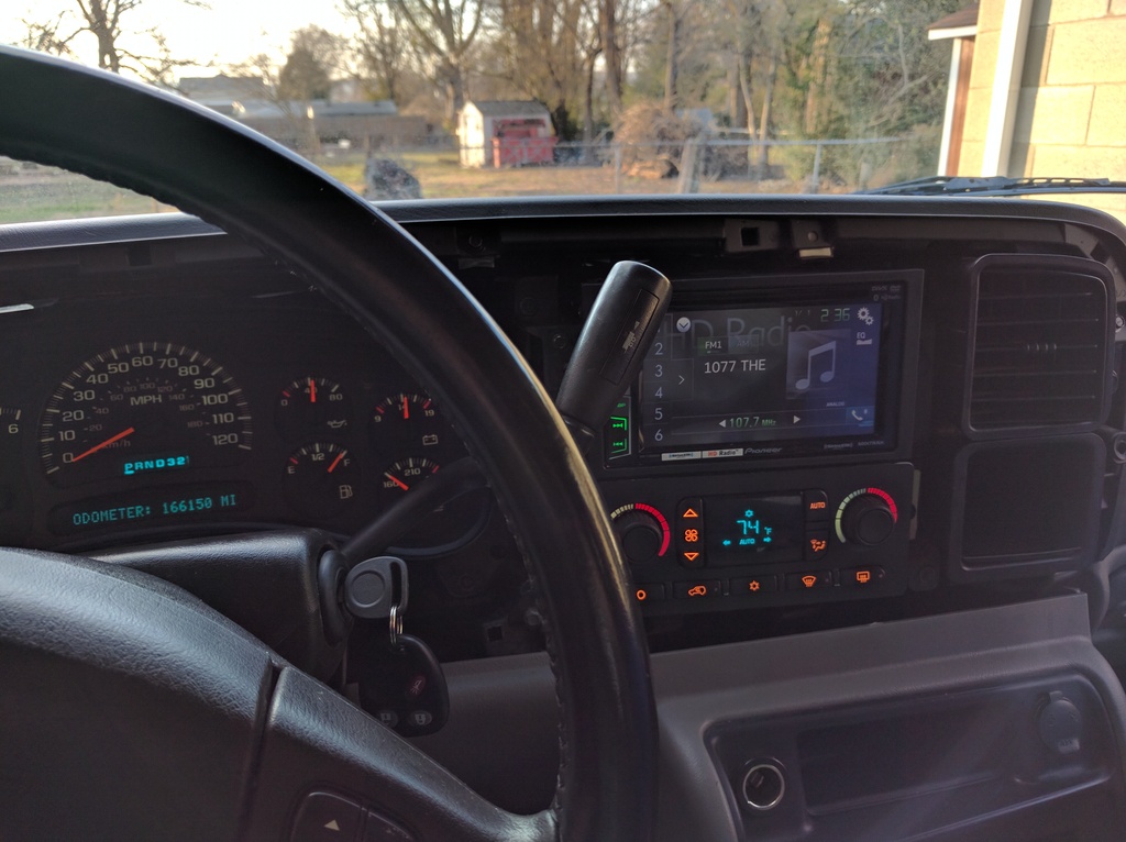

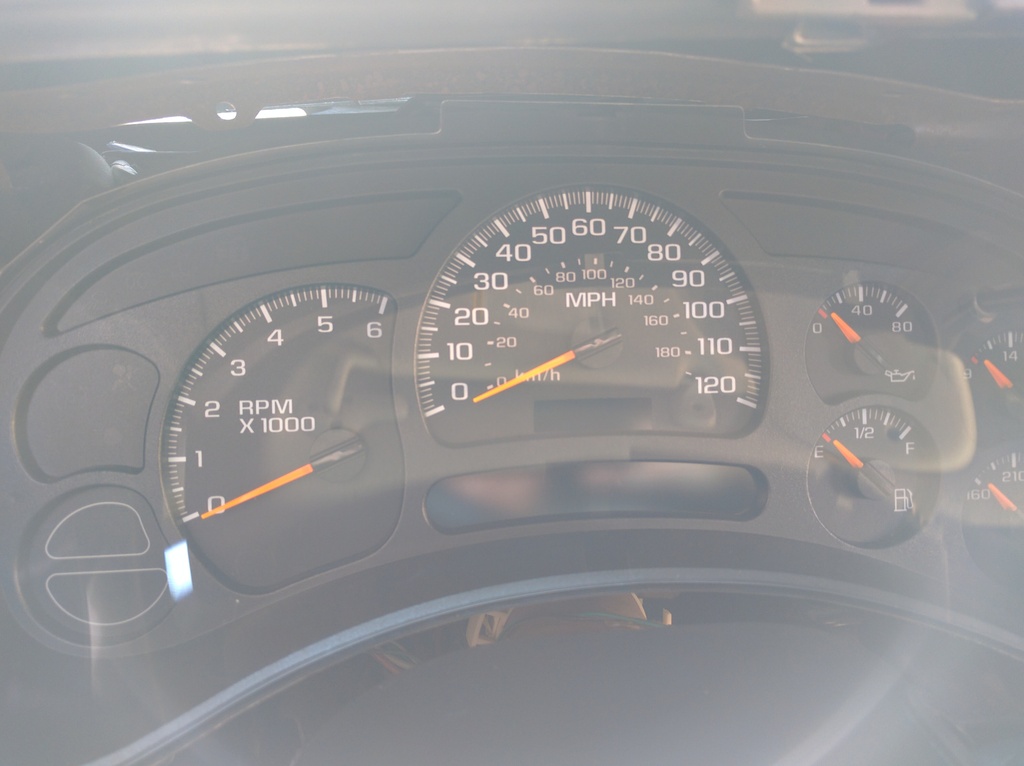

I just got my gauge cluster and electronic climate control in, guy did an AMAZING JOB. Total pro, cleaned everything up, all the glass, looks brand new. If you need a DIC fixed, or a cluster rebuild with motors and bulbs http://www.chevyspeedo.com/is the place to go! SUPER FAST TURN AROUND. A+
Looks brand new!
Before
AFTER!

Very clean cluster you have. That orange is pretty unique. Can't say I've seen that before.
Any plans to redo your steering wheel controls and the other controls possibly from another vendor?

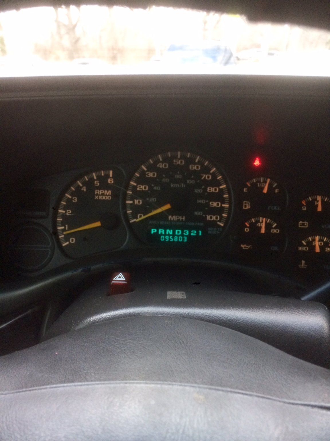

I see 4 gauges in the 4th pic that appear to be not zeroed correctly. The speedo, voltmeter, engine temp and oil pressure. Those needles should be at the min. spot of the range not below. Doublecheck by turning key on and then needles should bounce then goto min point range of each gauge.
