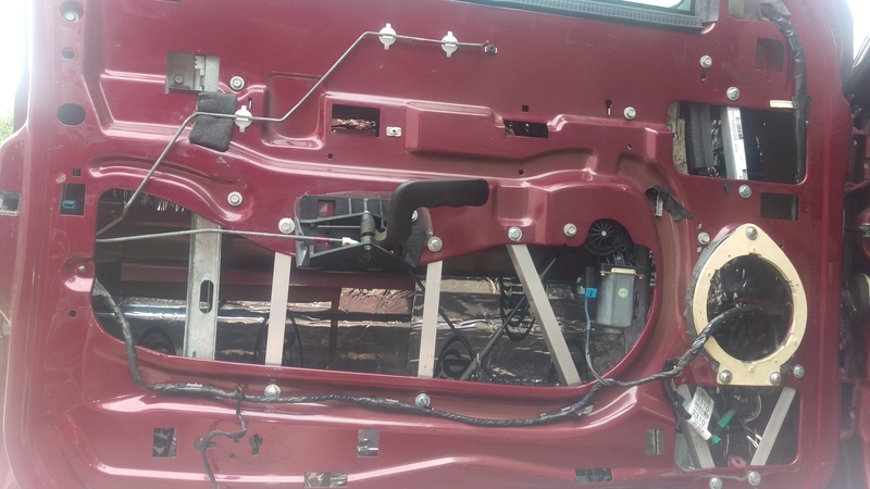

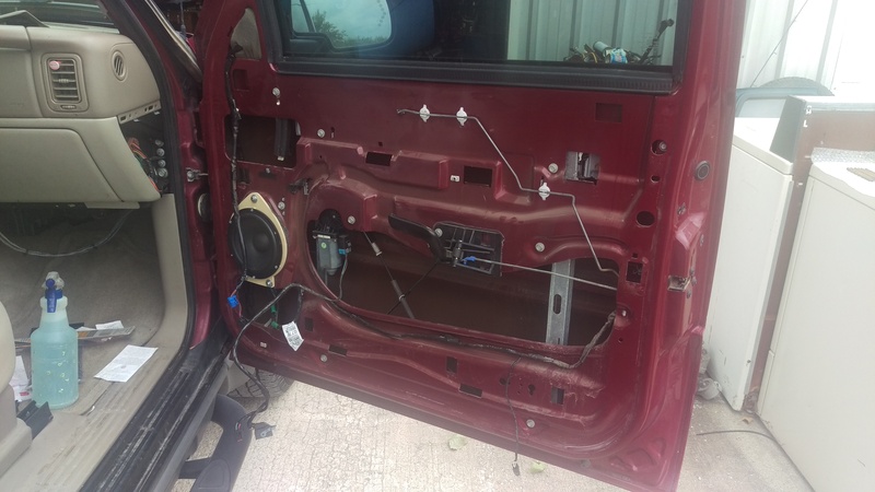

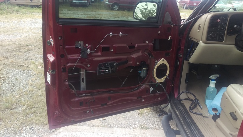

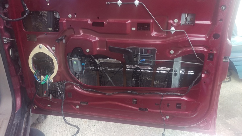

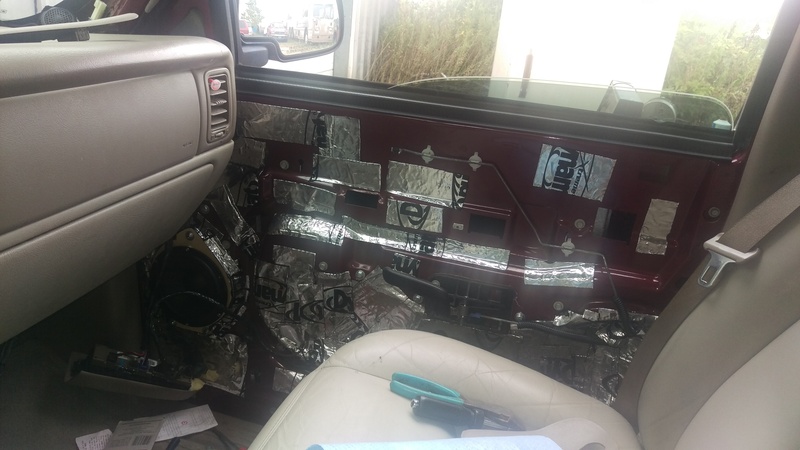

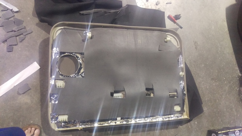

Have a friend that says he has it down to about 3 hours from start to finish. I almost want to time him. Feel like I will be more satisfied with it if I go at it on my own though?
Plus I like taking my time when it comes to deadener

When you get done with the deadener, how much weight will you have added to the truck?

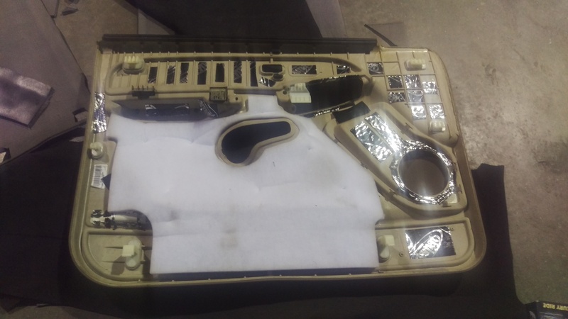

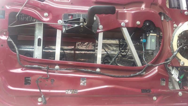

hmm good question.
the dynamat I just ordered if I use it all will be 60-70 pounds
the mlv is about 1lb per sq ft and I will probably be adding around 120 square feet and the ccf maybe 10 pounds?
I would give a rough estimate of about 200 pounds which is a lot of weight but I doubt the ole hoe will notice
