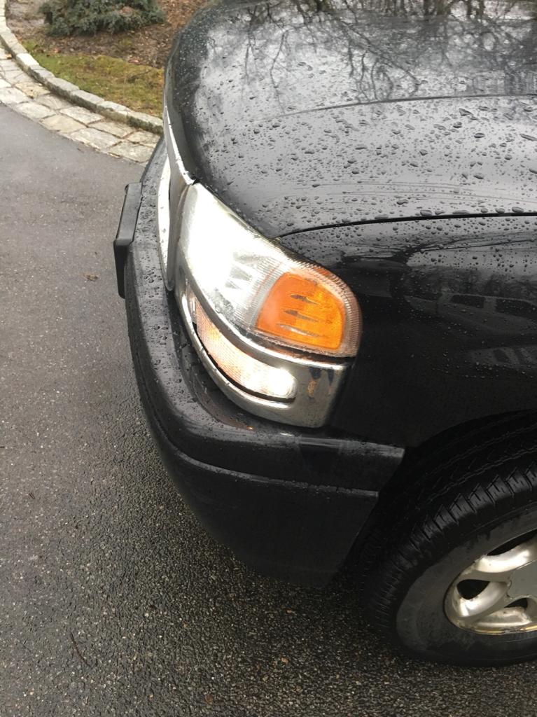

Four down, like 16 more to go!
Bought a bulk pack of 194’s, I think I have 4 more places that take those, but it’s cold and wet and I really don’t want to be doing the bumper lights or plate lights right now. I’ll use the rest eventually.
Did the map lights and courtesy lights today.
Gotta order festoons for the dome lights, even though I read like 40 times they needed 42mm festoons I still thought they were 194s.
Looks dumb when the lights come on and the front is 6k and the rears are yellow.
ETA: Wow, that picture quality is horrible.
