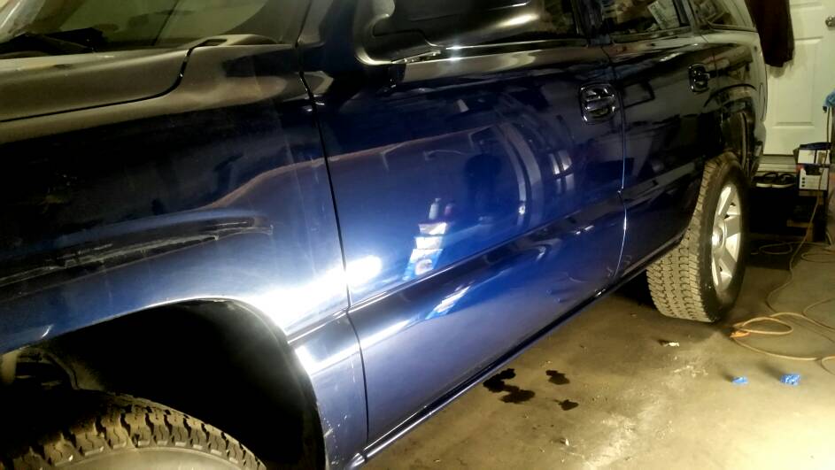

Clean under lighting install, any new pics of the final product yet?
Lol..... um that is final product :confused:. Just gotta hook up a switch. What am I missing , did I leave something out?

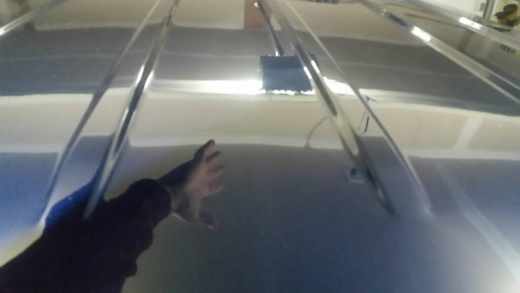

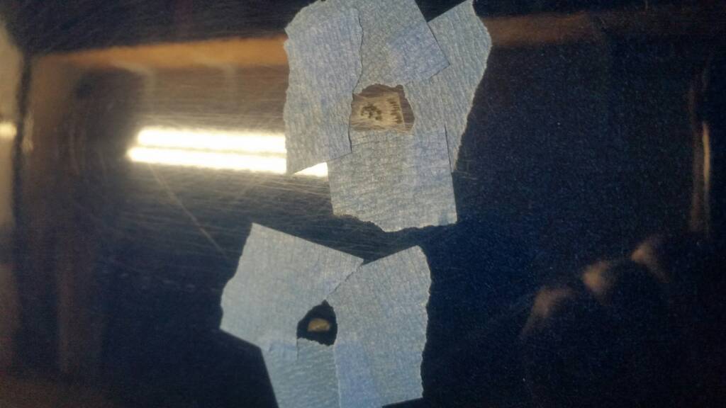

Been anxious to see how I did this, and @Fosscore too lol. After a few different brainstorming ideas I came up with this. Most of you would cringe drilling into the hood but it had to be done to have these flush and create a good clearance.
Got these for brackets since I can't reach behind the hood sub frame to tighten.
Off to home depot again.
These X2
Drilled
Painted
Had to drill two small mounting holes and a half inch hole for the led bolt shafts to fit through. Tightened it onto the bracket then used another nut as a spacer cause the shafts is too long. Later I'll shave down the shafts and give more room to make these 100% flush
Hooked it up to the auto start kill ground. Then power directly to battery.
Measured and mounted. Installed this is what gives full illumination on the engine bay and deep down into the bay for most any repairs, or just showing off engine mods...which I have none lol
