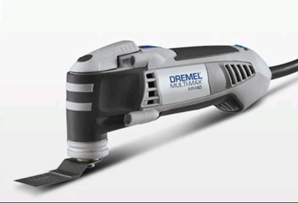

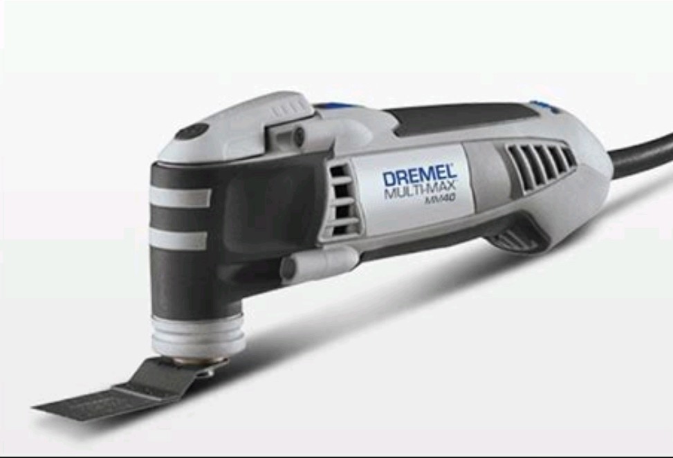

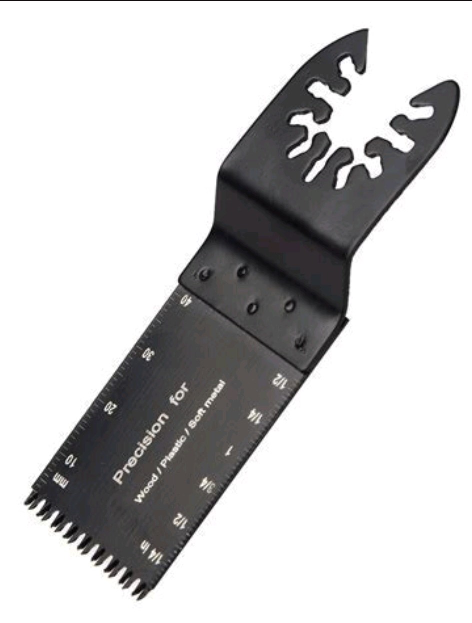

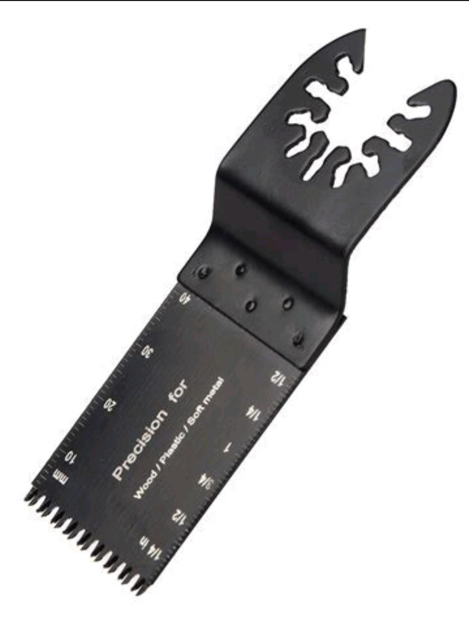

I wonder if anyone has tried a linoleum cutter.
The plastic is somewhat thick, as one would expect, so power tools will definitely work better.
The other issues with knives, is that if you slip up, while putting lots of pressure on the blade, you may end up cutting yourself badly. When I used the utility knife with new blades to cut the two short sides of the triangle, the blade slipped out of the groove and nicked my thumb on my other hand, which I was using close by for leverage. Fortunately, it was a nick, but another fraction of an inch in the blade's trajectory, would have sent me to the doctor for stitches.
Again, an easy job with the right tools and some caution.
