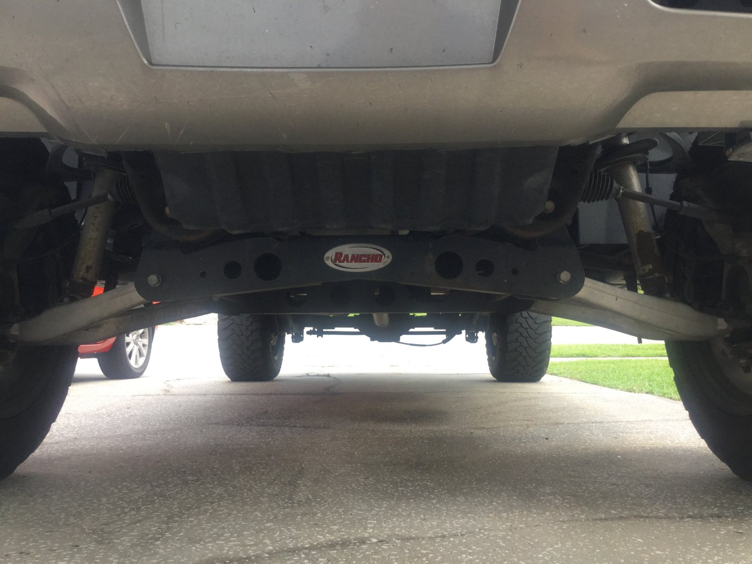

Don't think the remote start has any input on remote start. We can fix the suspension light with some resistors or module. Also can figure out your lift but need a picture of front drop cross member

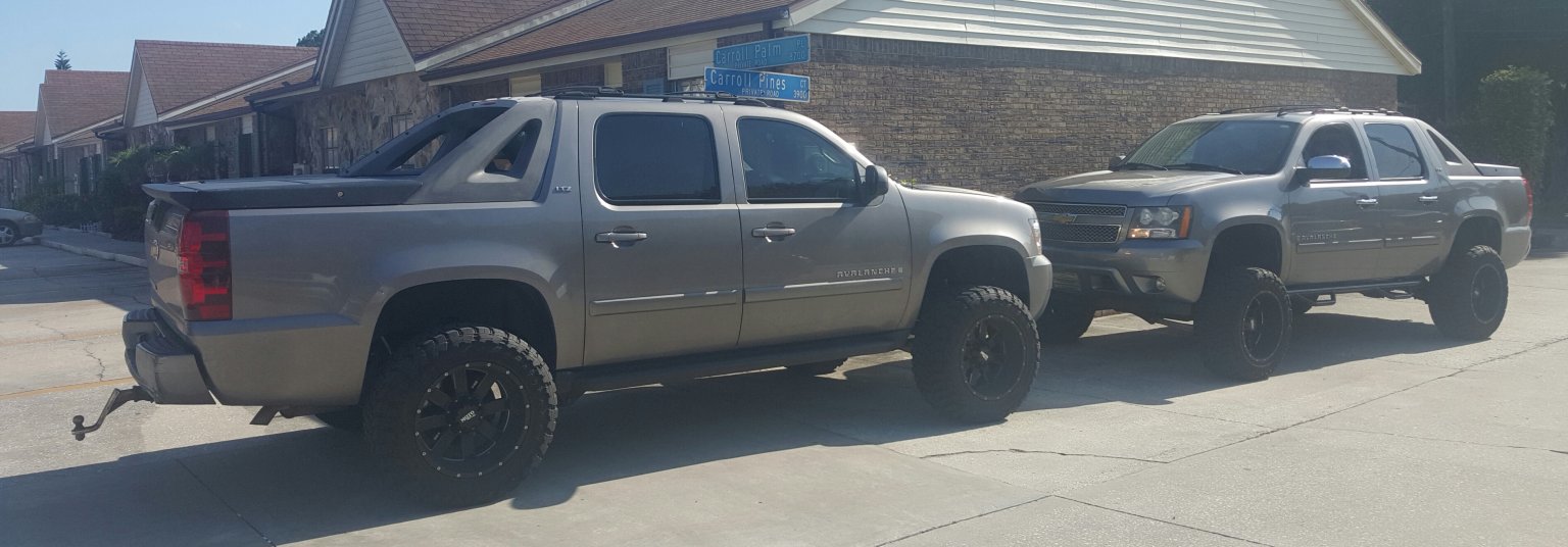

I'll grab one tomorrow in the light. Has a rancho sticker but definitely more than a 4" lift. Local guy with the exact truck (wheels,tires, year, color, options) pulled me over last week with a 9" full throttle lift and has about an inch on me.
Would the vin indicate options that came with the truck?

Interested to see what lift it has since FTS only makes a 7 or 10 but most people stretch the 7 to 9. Might be a rancho 4 as they measure 5.5-6.
