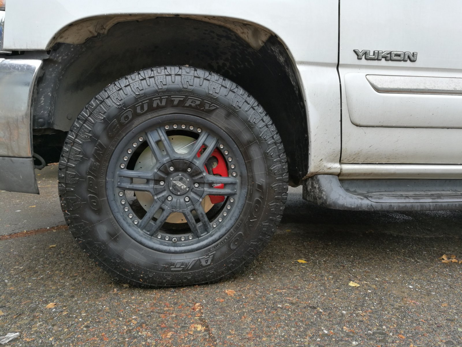

You must run 17" or larger wheels for these front calipers. My 16" steel spare does not fit anymore. Just a FYI
Yes this has been discussed. 17" or larger. You can get a new spare from a wrecking yard.

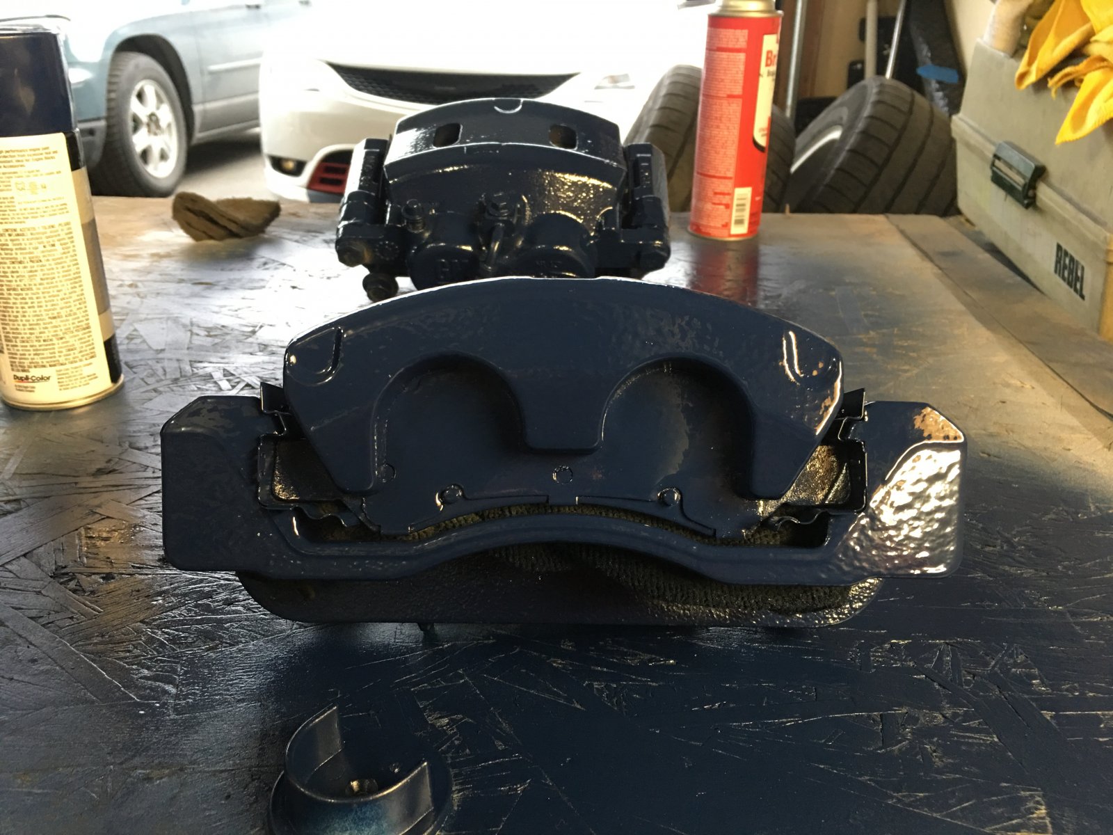

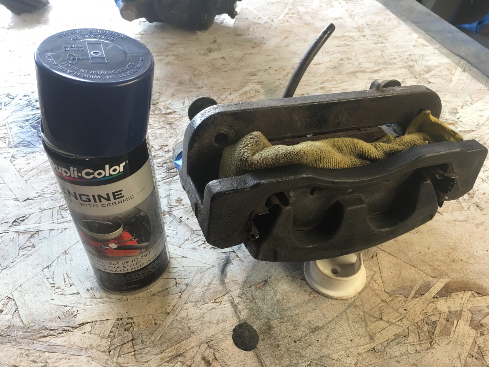

Thanks. Just gotta clean them up, paint them, rotor(s) and pads on transit and install them with new crush washers for the brake lines with new brake fluid and the fronts are complete... Was suppose to be a simple replacement store bought parts ($300 rotor/pads), after searching this site for rotor reviews and coming across this post, I went a different route and still saved $120 with supposedely added benifits. Hope I notice the difference after install of all parts.
