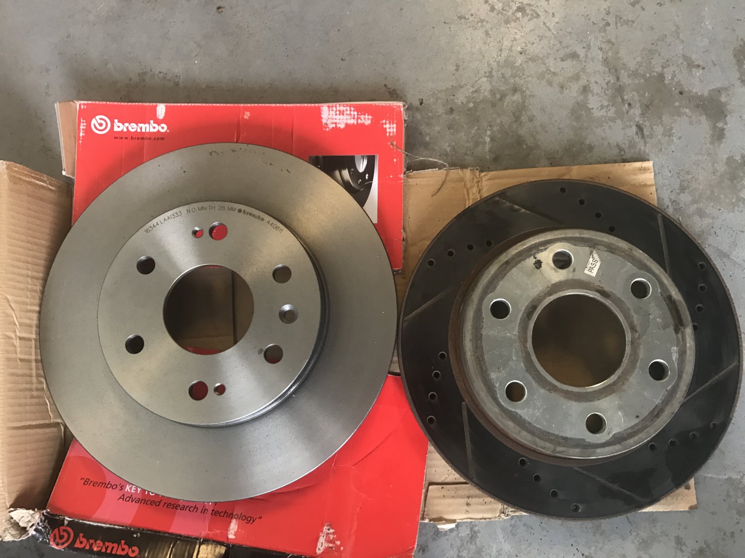

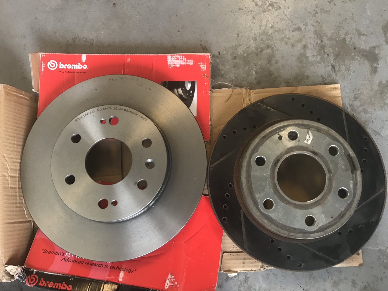

a1d0bebe535864d923f061a60028a790.jpgLook what the UPS guy just brought me!
Almost got all my parts, just need the calipers.

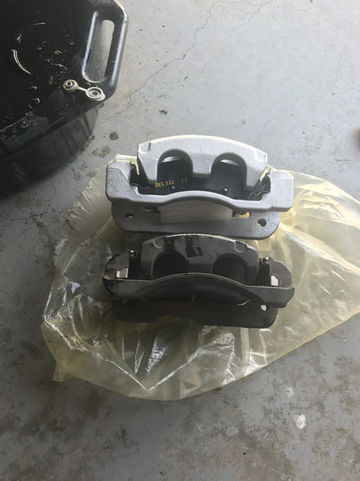

Weird, UPS brought my rotors today too! Got my calipers Monday and painted them, already had the brake lines. Just waiting on my EBC brake pads. Looks like Saturday is install day. Bought a pneumatic brake bleeder from Harbor Freight so hopefully it will be easy to bleed them.IMG_5284.JPG
