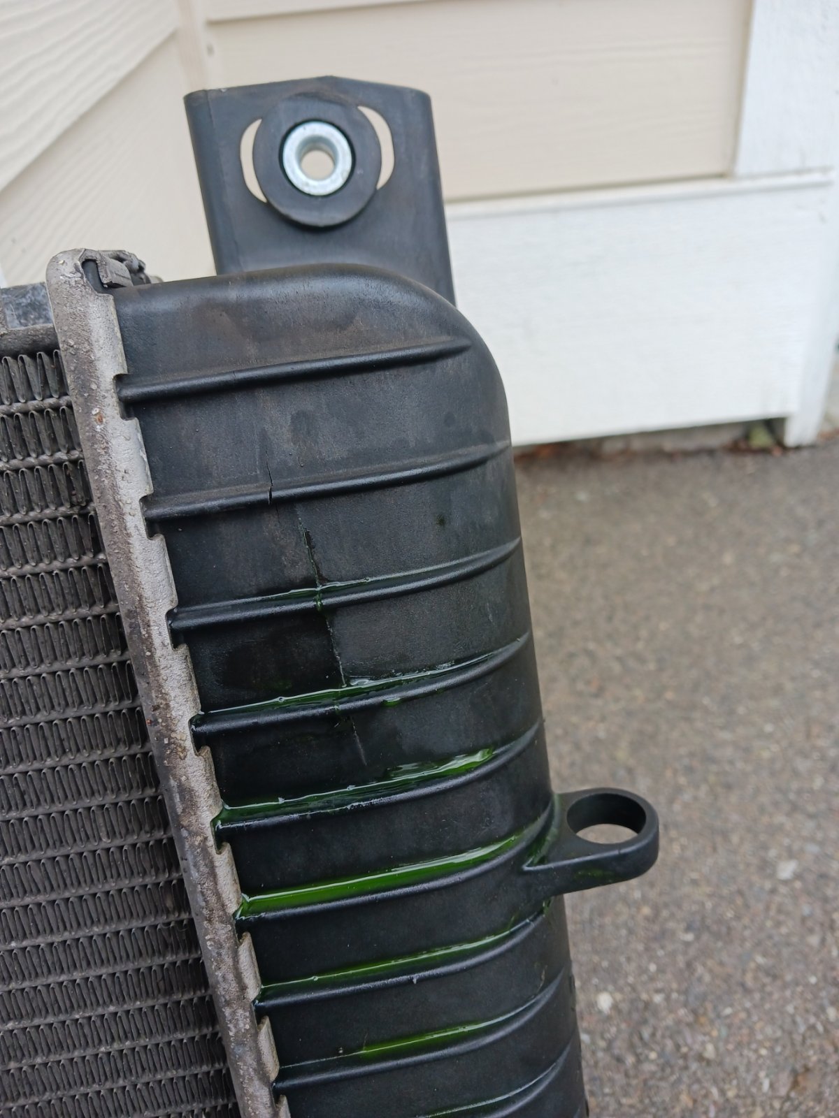

Now, the radiator leaks. I', ordering ACDElco one next, don't really want AM ones because of the transmission cooler... $252.
