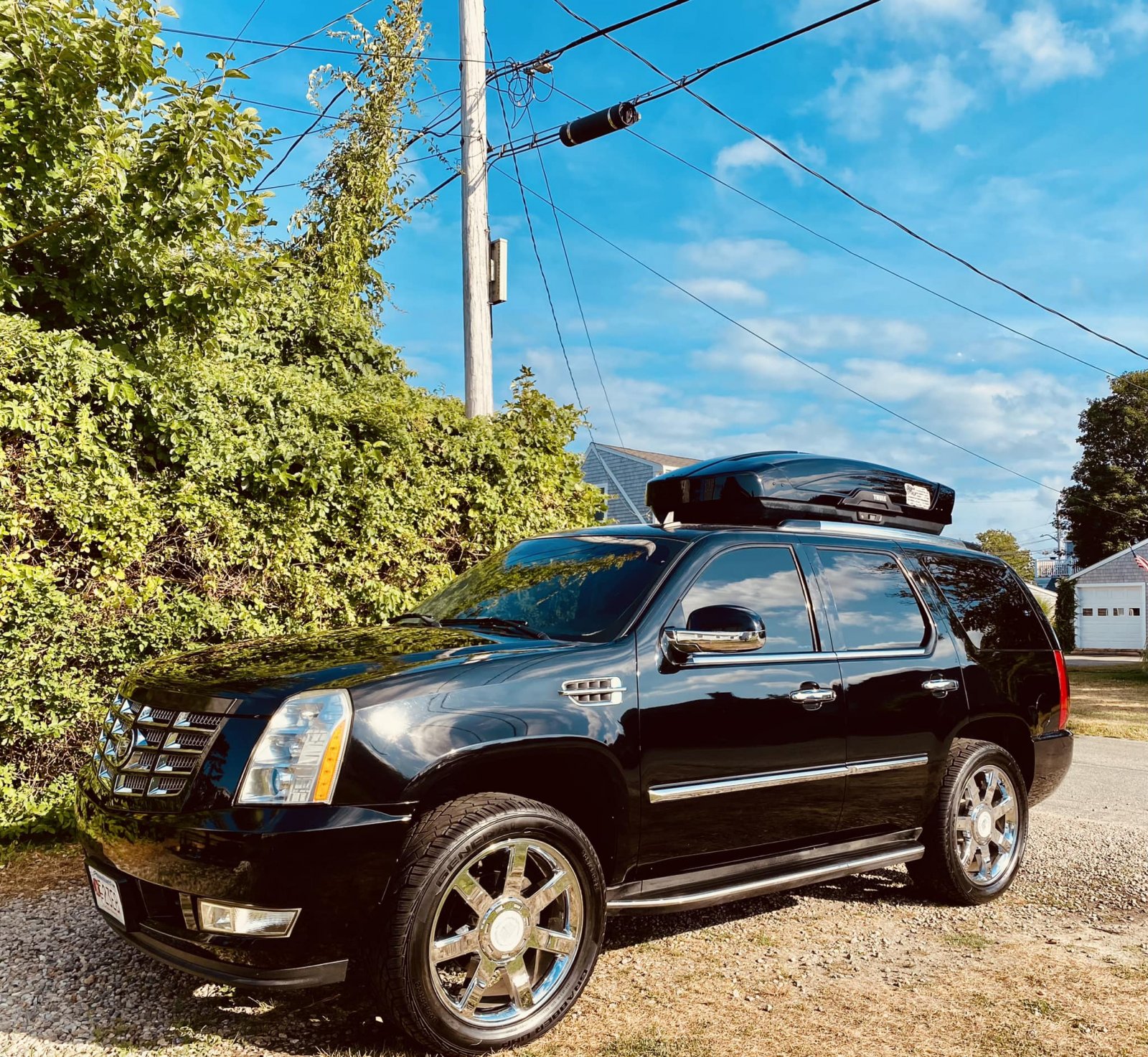

Hey folks, doing some follow up here as honestly it gets a bit confusing depending on what/where you ask. I have a 07 Escalade i picked up last year. Front struts have been replaced with cheap quick struts that are blown and already have resistors on them. Rear air ride is leaking and the compressor runs once every 25 minutes which is getting annoying and it squats over night. So my goal is to get a belltech 2/4 kit, but i really need to replace everything first.
Id want belltech or bilstein struts in the front but without direction cant figure out parts number as there seems to be at least 3-4 different kinds for both, assuming the quick struts are junk, i think i need to play it safe and get all new components such as the spring seat, front coil spring itself (do not want one that sits higher as currently its maybe 1" over stock) top perch, bearing and whatever else. SO without piecing that through rock auto which actually gets rather expensive what should i do?
And for the rear, i dont tow so i assume i would just match the fronts with belltech or bilstein. Can anyone give me some incite on the best course of action keeping in mind this is a truck i bought last year for around $10k, want to keep it for years but keep in mind its a budget truck. Thanks for the help - Bob. Oh and its 2WD btw.

Use Arnott air shocks from Rock Auto for rear.
Why not replace with gas shocks if i dont care about auto level for towing? wouldnt ride worse would it? and would just eliminate the rear compressor and have less to fail?
