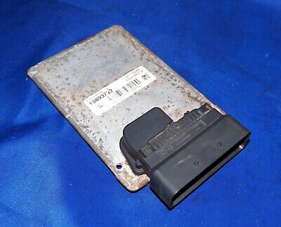

there is a level control module also check that. it should be up under the frame in the rear, if you google a little you will see where it is located and what it looks like, should have a wide wire harness, triple row
should look just like this one
