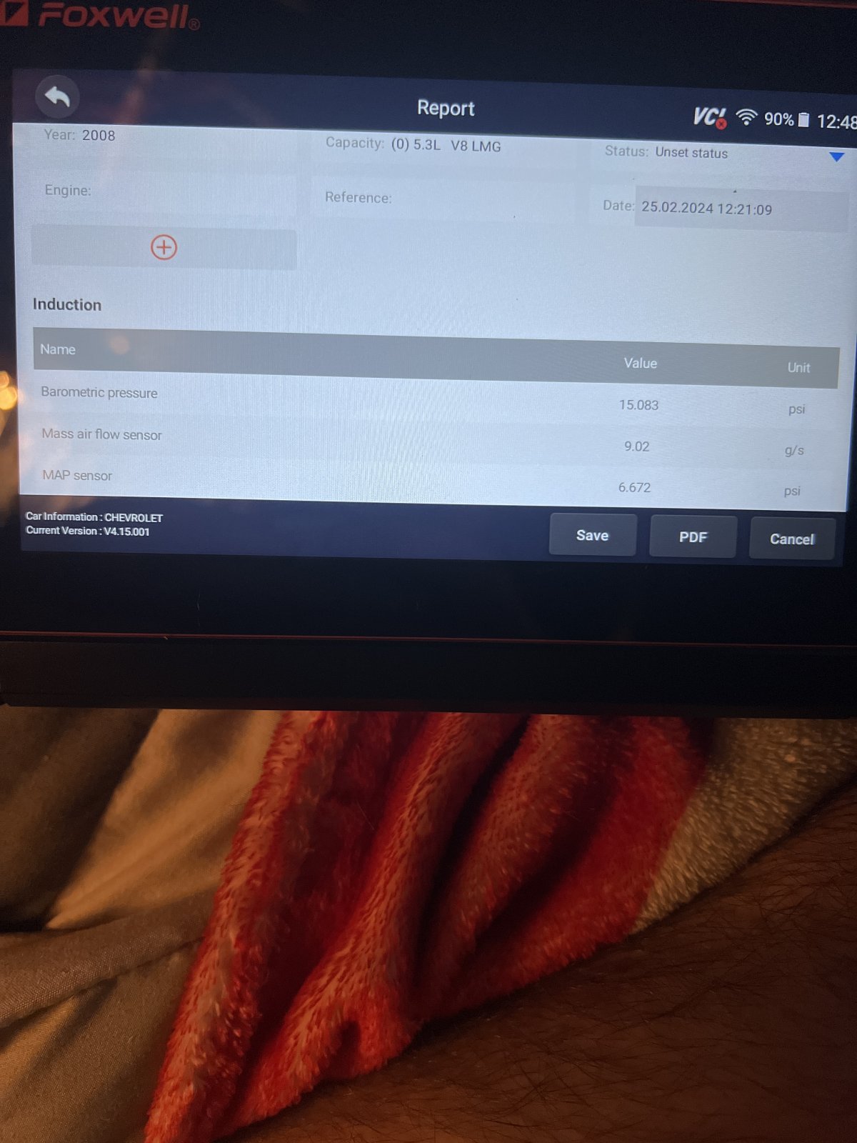

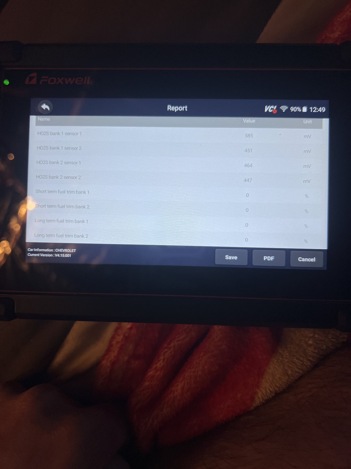

Pump gas 6 mos ago tune up plugs wires coils oil every 5000 truck is stock new cats and Bosch o2 sensors plugs are ac delco platinum gapped at .040 I checked before I put in and ac delco coils and wires one day it ran fine next morning go to work and it would start then die but only start if I feathered the gas codes were lean bank 1and 2 cars below threshold p0300 and a intermittent fuel control module loss of communication I have a bi directional scanner I’ll get trims and o2 voltages today 02/25
