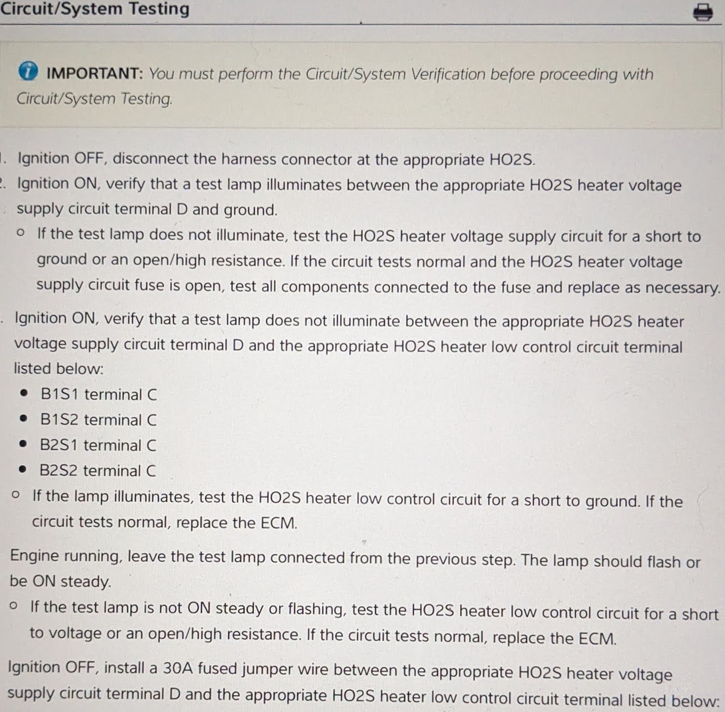

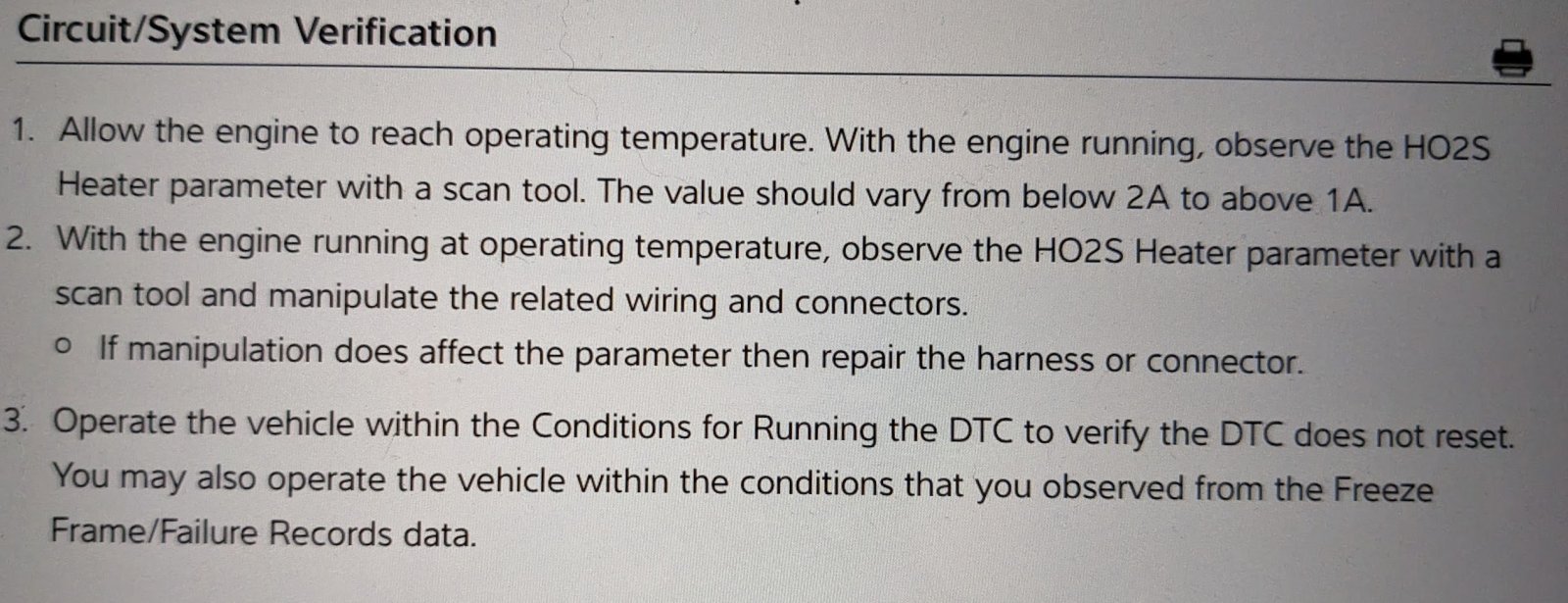

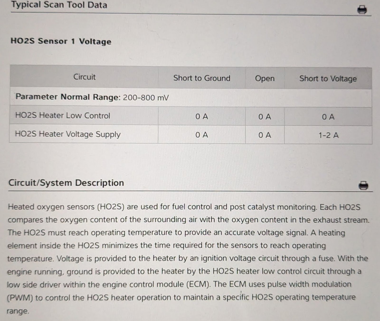

The O2 sensor readings are very near what they would be if they're not warmed up. You might want to check the O2 heater fuses and make sure the sensors are getting heated up so they can work.

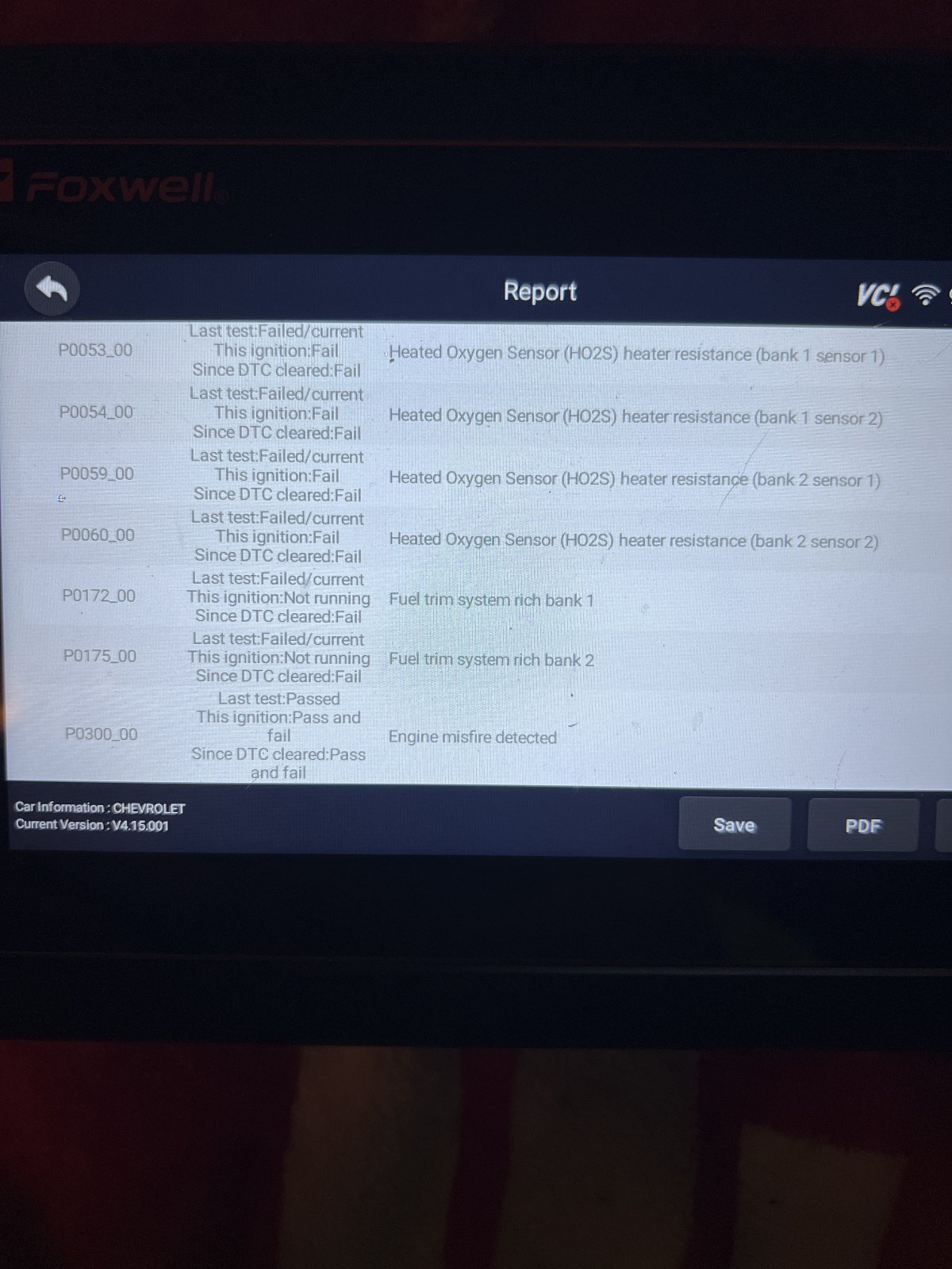

I'd have to look up the codes and what the ecm does when those specific o2 sensor codes are thrown, but it very well could stay in open loop if both front o2 sensors codes are set. might have to clear the codes before it will go into close loop. but look over the freeze frame data first if it has it that will be lost when cleared.
my 2 cents on o2 sensors is I'm not a fan of Bosch. but I'd hate to say change them if newish. Just keep in the back of your mind they could be fouled out like the spark plugs were. the obd codes usually have a : and then 2 more numbers that are more specific as to why it set the code if your scanner can see them. it could be as simple as the heater circuit fuse is popped and the got cold and fouled.
It did have more to I’ll hook it back up and let you know what I says it was something with the heater circuit if I remember right but I’ll get what the reader says also it take a while to start like if I don’t put my foot on the gas it won’t start

I’ll check the fuses I haven’t checked that yet thanks everyone for chiming in it helps even if I haven’t fixed it yet but I will fix it and hopefully on my own without taking it to a shop it was runny decent to then I had those lean codes and my mpg dropped from 15 a gal to 12 real fast so I changed a few parts like the o2 sensors fuel injectors and coils and wires and plugs
And those o2 sensors are new new like I put them in when I did the cats a few weeks ago when this problem started it gave me the cat below threshold code and I know all the parts are original so I figured couldn’t hurt to change them since the truck was acting up anyway so I put new cats new o2 new plugs new wires changed the oil and still ran the same takes awhile to start and will only start if I put my foot on the gas then it’ll act like it wants to die unless I keep it running then after a min or so it’ll stay running but then the check engine light flashes I’m assuming cause it’s misfiring
