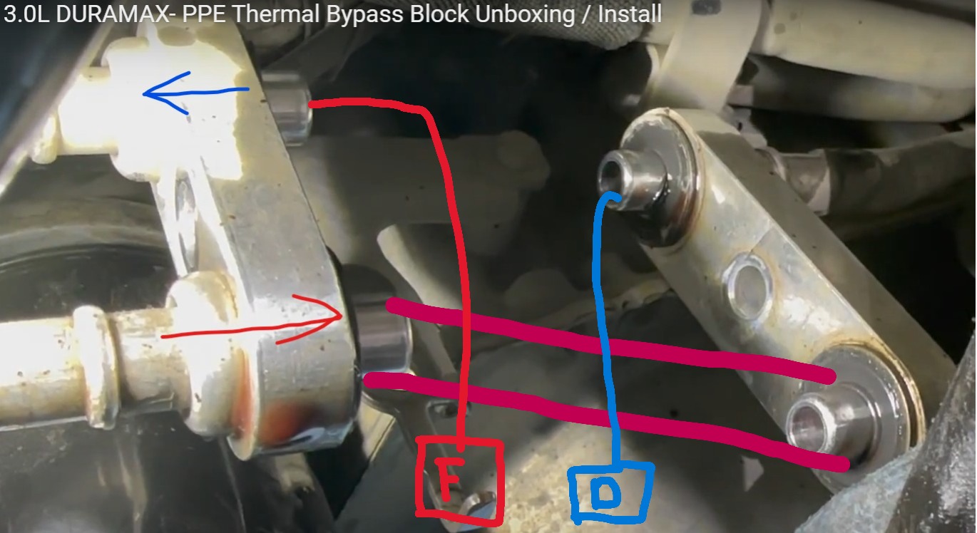

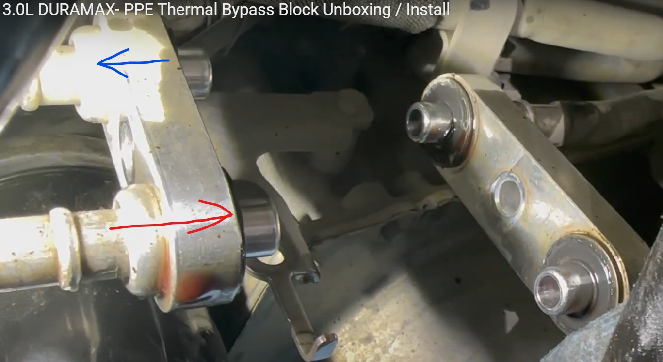

The only sketchy part is disconnecting then reconnecting the transmission return line. I use a small pick with a curved end to partial remove the "don't lose me" clip then grab it with a needle nose. There may be a tool that slips over the return line that slides in to release the clip. None of mine fit.
I used 2 8ft of clear hoses to capture the fluid. 1 3/8" OD & 1 3/8" ID.
You should install the "don't lose me" clip before installing the transmission return line. When installing the return line it should just click in place. If correct the black collar will slide on & be 100% flush. If not 100% flush that line or clip is not right & the line may pop off later..
