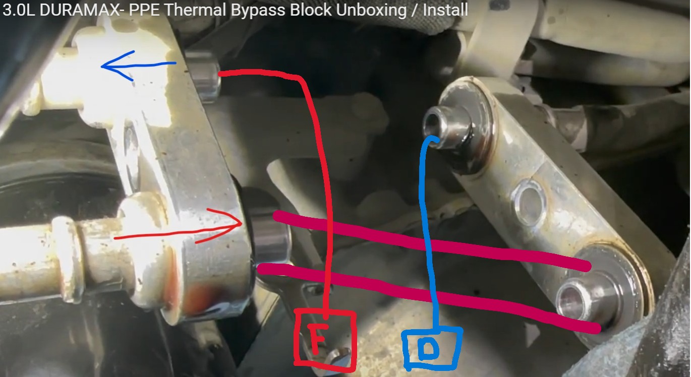

Planning on preforming filter change and trans flush on my 3.0 LM2, Tahoe (30K for the 1st change)
Drop pan, change filter and refill in level check side plug. Then follow steps below to flush.
The Transmission Fluid Thermal Bypass Valve, fluid doesn't flow to cooler until above 160-170d.
Hoping there is enough length to push hose on and hose clamp on Tranny connection coming from connection block to preform fluid exchange. see screen shot
1 Disconnect at Bypass Valve. Attach to tranny lines where they attach to bypass.
2 attach hose to line to trans cooler to pump fluid out
3 attach to line returning to transmission to pump fluid in with Vevor Transmission fluid pump
4 Perform exchange.
5 flush the trans cooler. Using Vevor Transmission fluid pump
6 reconnect cooler lines to bypass valve
7 reconnect tranny lines to bypass valve
Similar to the way he performed with a conversion block.
In this video the Bypass is mounted to the Tranny Housing
If unable to attach hoses to lines coming from tranny, will attempt to use PPE bypass, tapping threads on the cooler side body to accept fittings and attach hoses for flush procedure. This will become the adaptor for future flushes.
Tried searching for adaptor, special tool, cant find one on-line.
Dealer wants $350.00 just for flush.
