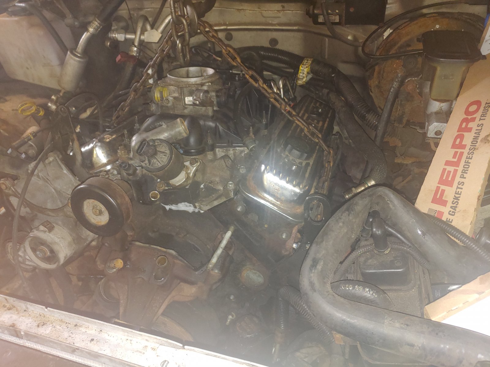

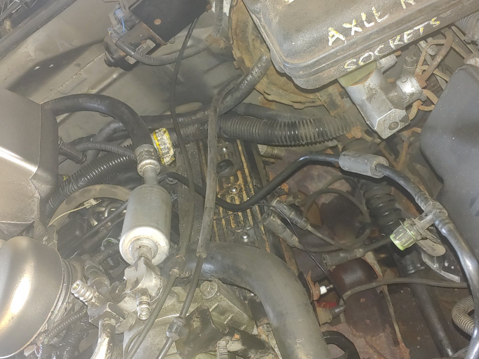

PNW VietVet.... So I came across some bad news, and got some good news today. I decided to take a closer look at my block since it was stripped. There was a crack between cylinders 4 and 6. (Pics included) so... I ordered a brand new crate long block for her. As i said Never getting rid of it!0527211008~2.jpg0527211008.jpg

Ok, well, you kind of wanted to go that way anyway and now you have a great excuse for the wife for why you HAD to order an engine.
Where did you order the engine from? What warranty with it? Stock block or some upgrades?
When you look back at your original heads and block pics, looks like the #4 and #6 cylinder piston tops are the cleanest ones.
Have you already made your list of what else will be done since you took it all apart? Hoses, belts, water pump....etc.
Gonna stick with conventional oil, if that is what you ran or are you running full synthetic?

As big as that likely got when hot, I am amazed that you didn't have two really bad cylinders misfire.
