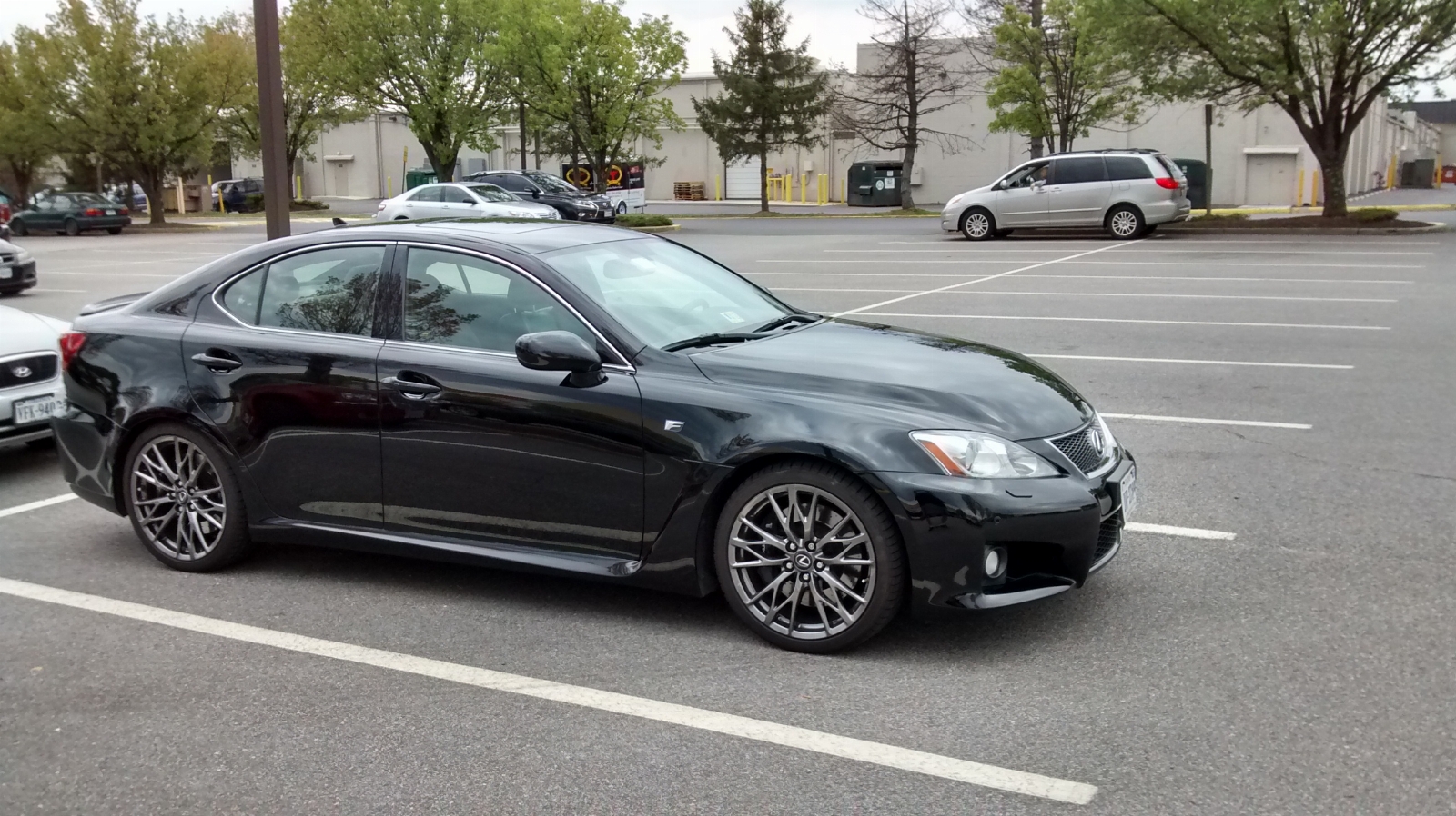

I'm also eyeing this. The problem is that shipping is over $100. I can pick it up locally but as you might have guessed, I don't exactly have a working truck right now. No way this would fit in my Lexus.
