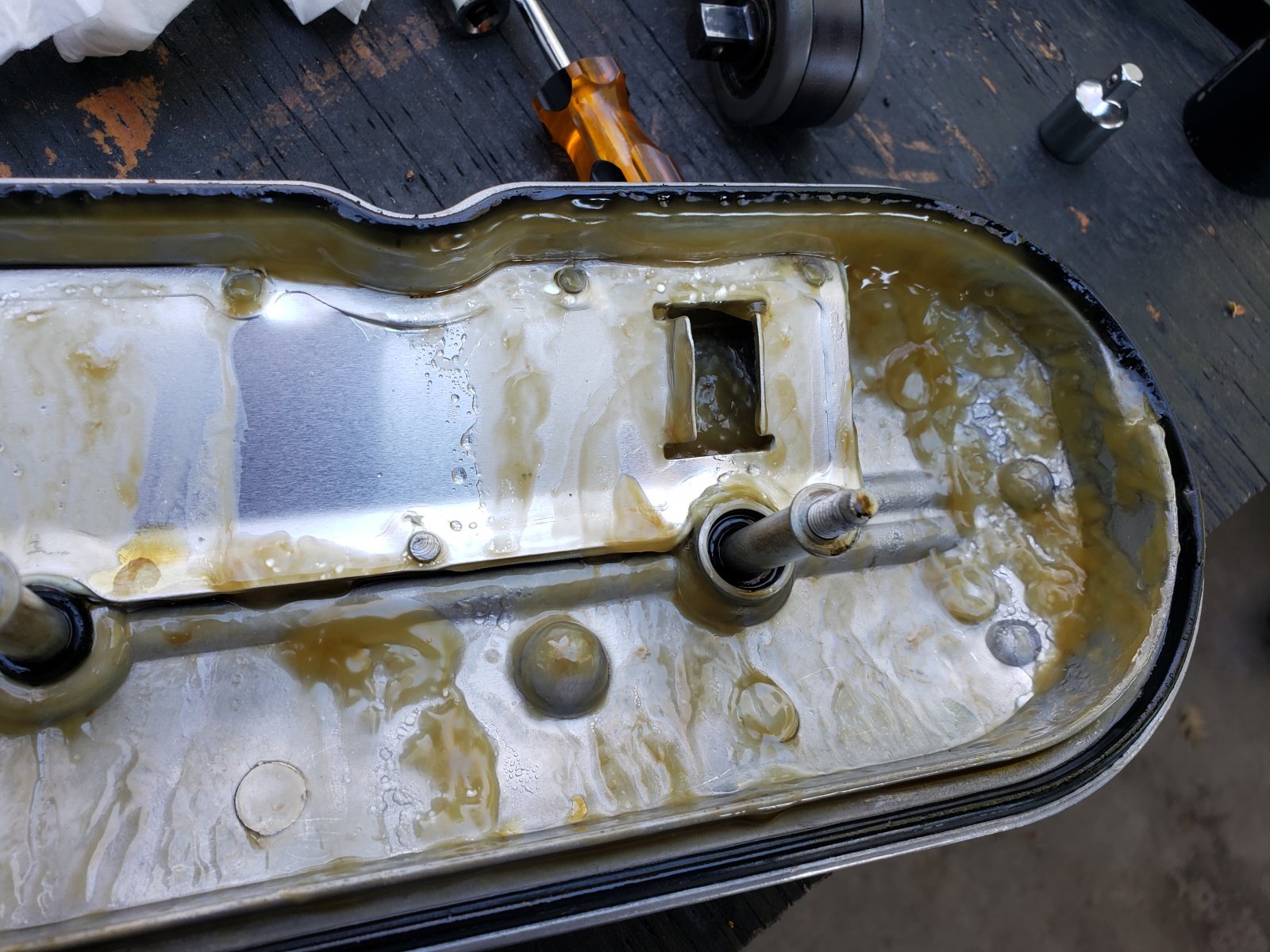

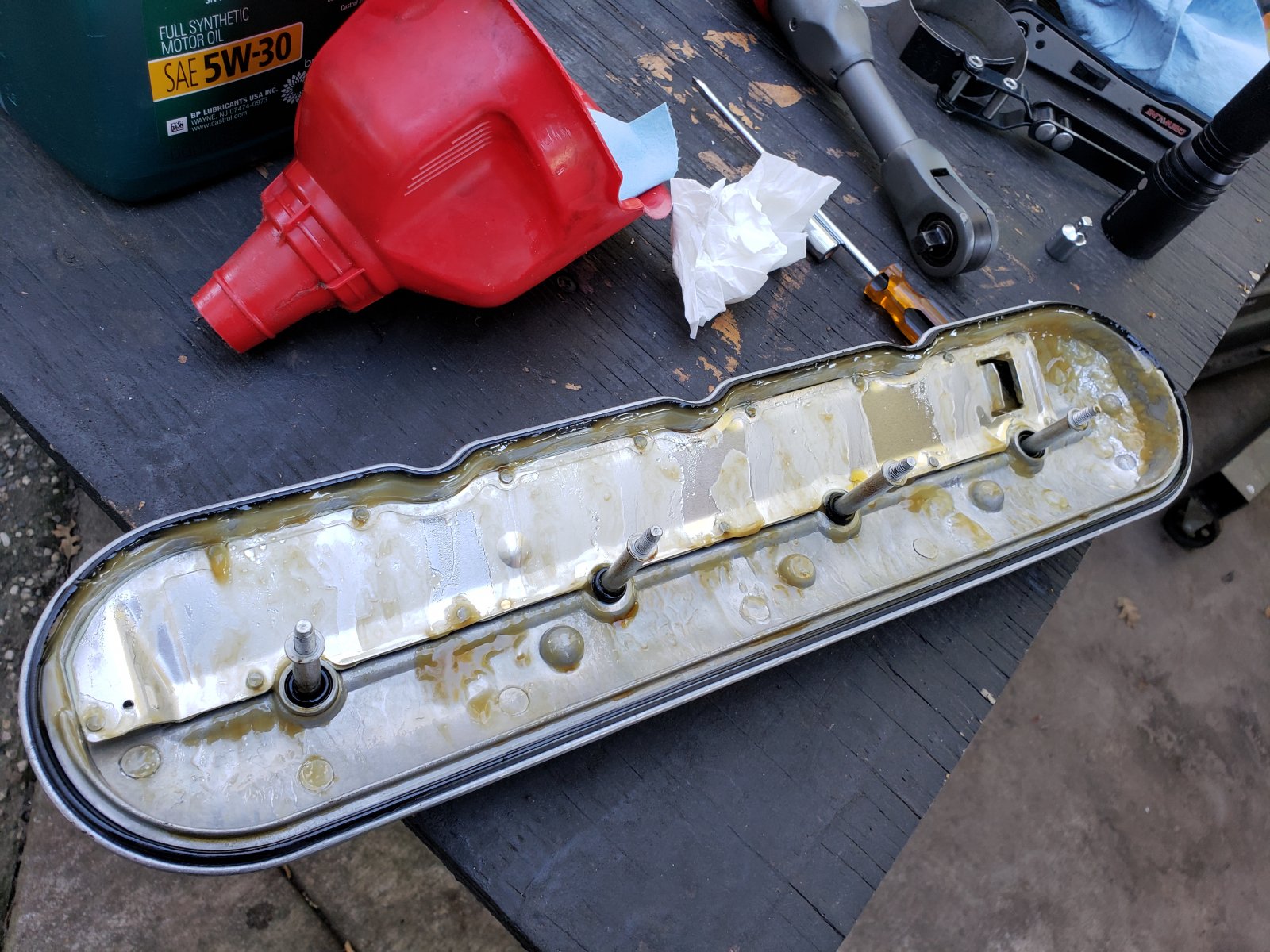

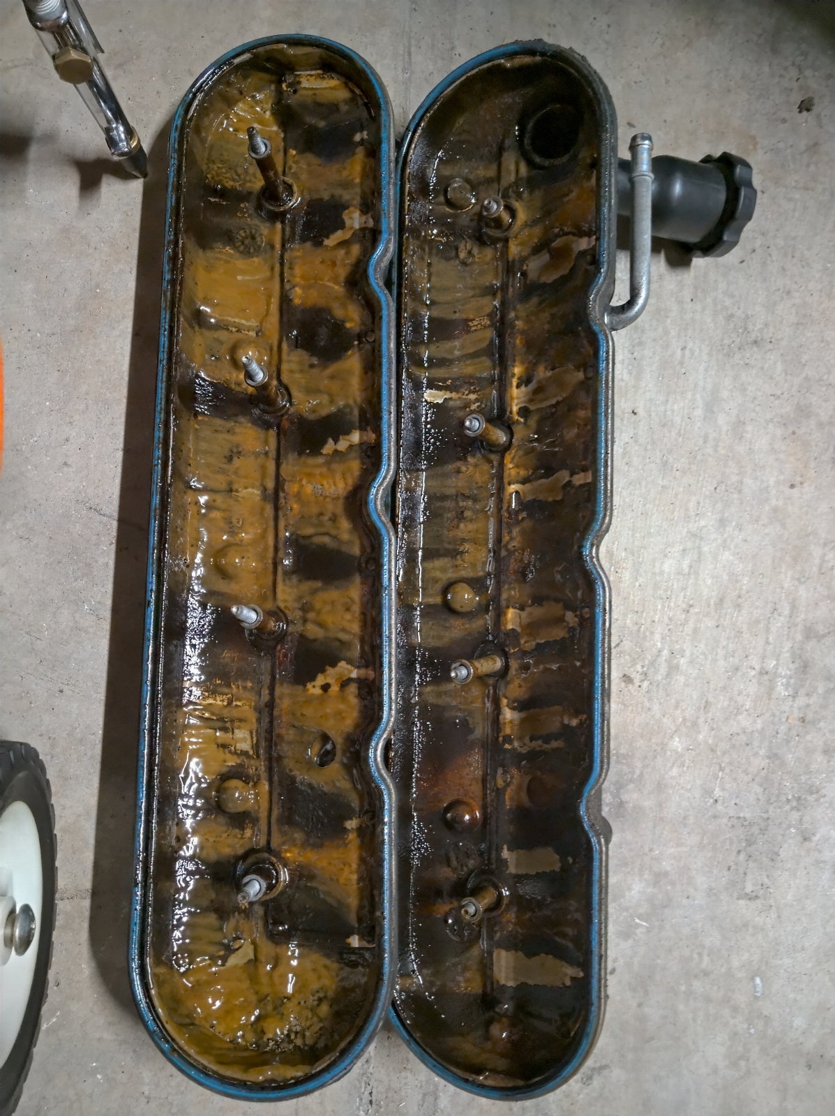

Any comments? I think this picture is the beginning of sorrows. LOL Please confirm for me. This looks like sludge and I change my oil every 3k miles come rain or shine.

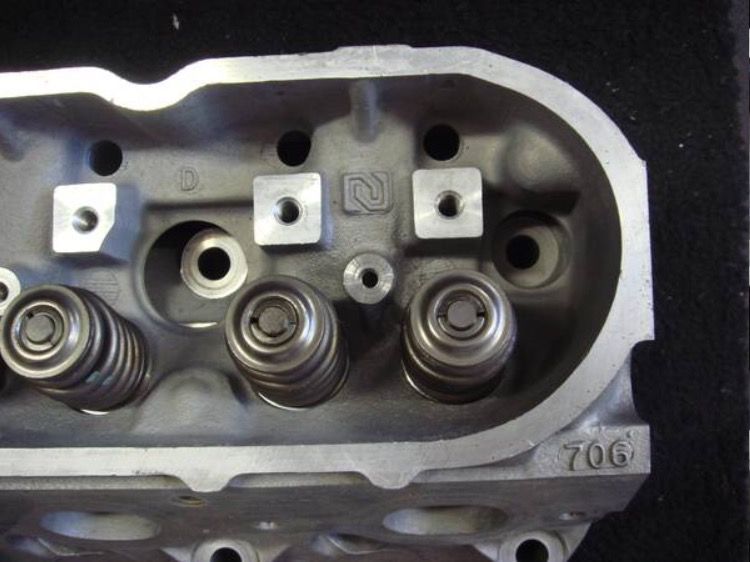

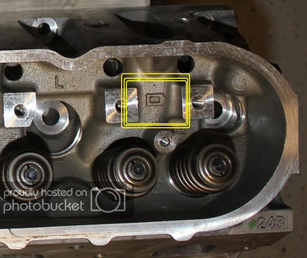

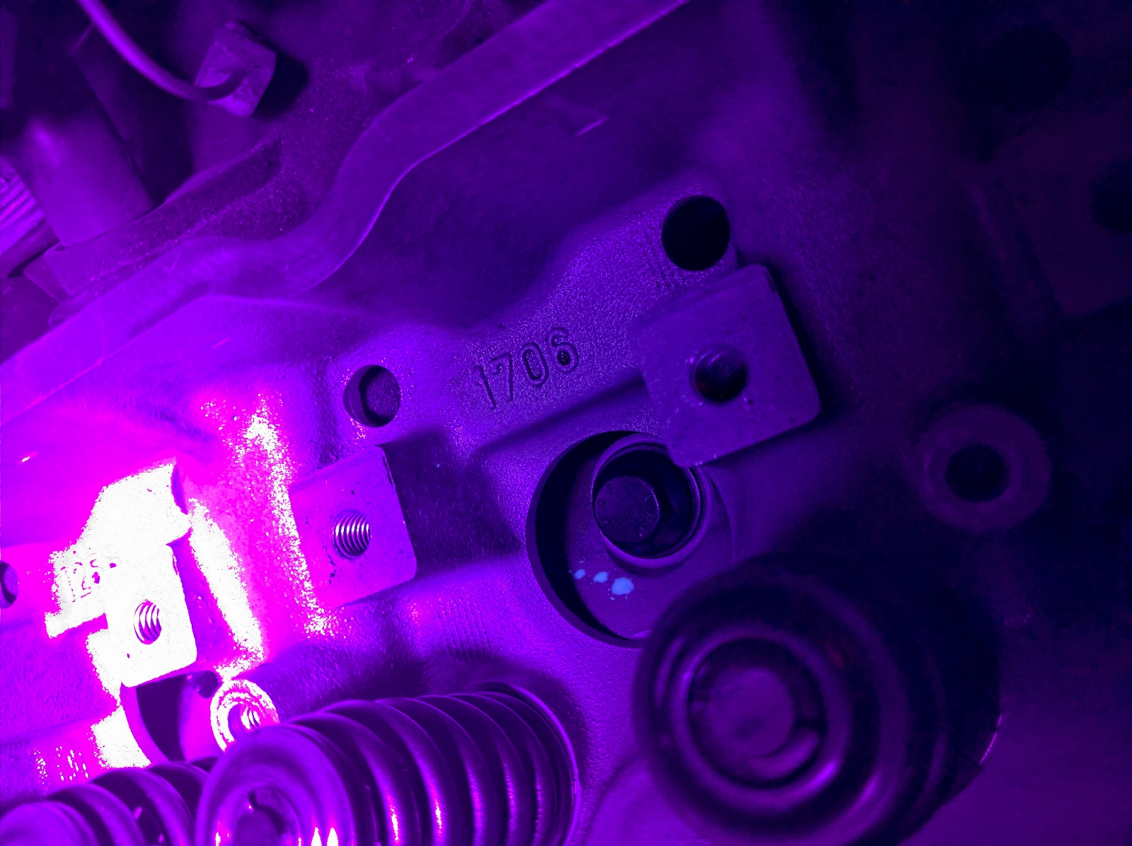

His was really bad as it had been going on for a long time. He had only owned the truck for maybe a year, if even that. I wouldn't be surprised if that was why the previous owner got rid of it. Under the cover and all inside the engine was thick and black gunk. You would've noticed that had yours been that bad. If yours is cracked, it could be somewhat recent and you can easily save it.
At the time, we couldn't find any known good heads. We figured our safest bet would be to track down non-Castech 706s but we found none. We ended up putting some low-mileage 799s from a 2010 5.3 on it. He lost a little compression with them. But, they were cheap and it's just his camp truck. I couldn't steer you towards any particular source for a rebuilt head. In my mind, they're all a risk. So, find someone reputable that is very much aware of such a failure and warranties their product. IIRC, a member here bought a head (or set of heads) from a rebuilder and one was cracked. The Castech failure mostly happens around the head bolt holes and doesn't show unless the head is installed/torqued down.
I see hints of milkshake. But, during cooler weather, and especially if you do short trips, it could just be condensation that hasn't burned off yet. So that's not definitive. I feel I'm being a bit too optimistic, but we gotta remain open-minded, right?

Thanks I have sludge in the oil so something is going on for sure!
Snowdrifter and Bill made valid points. I was focusing on diagnosing a Castech failure versus a head gasket failure. Cracking around the bolt hole(s) exposes a water jacket to the oil under the rocker covers and not combustion pressures/gases to the water jackets. Being thrifty, I'd take a closer look under the cover since that costs nothing. I agree with having an oil analysis and I have one done with every oil change. But, that takes about two weeks for the results and things could suddenly get worse in that time- making the damage more severe.
