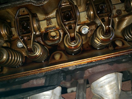

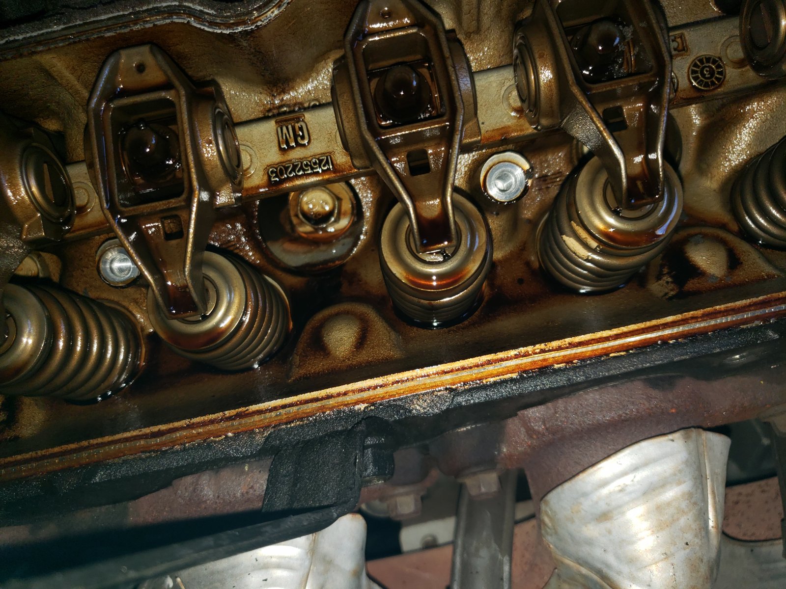

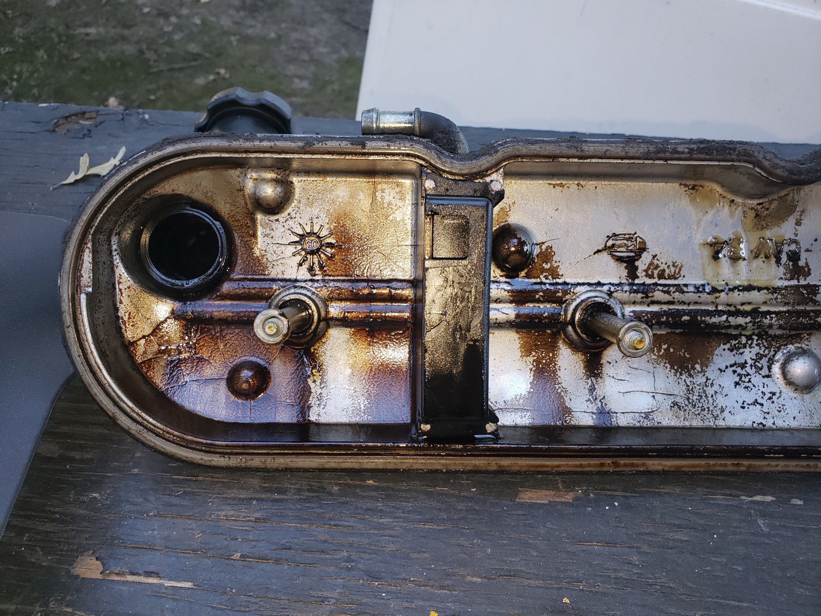

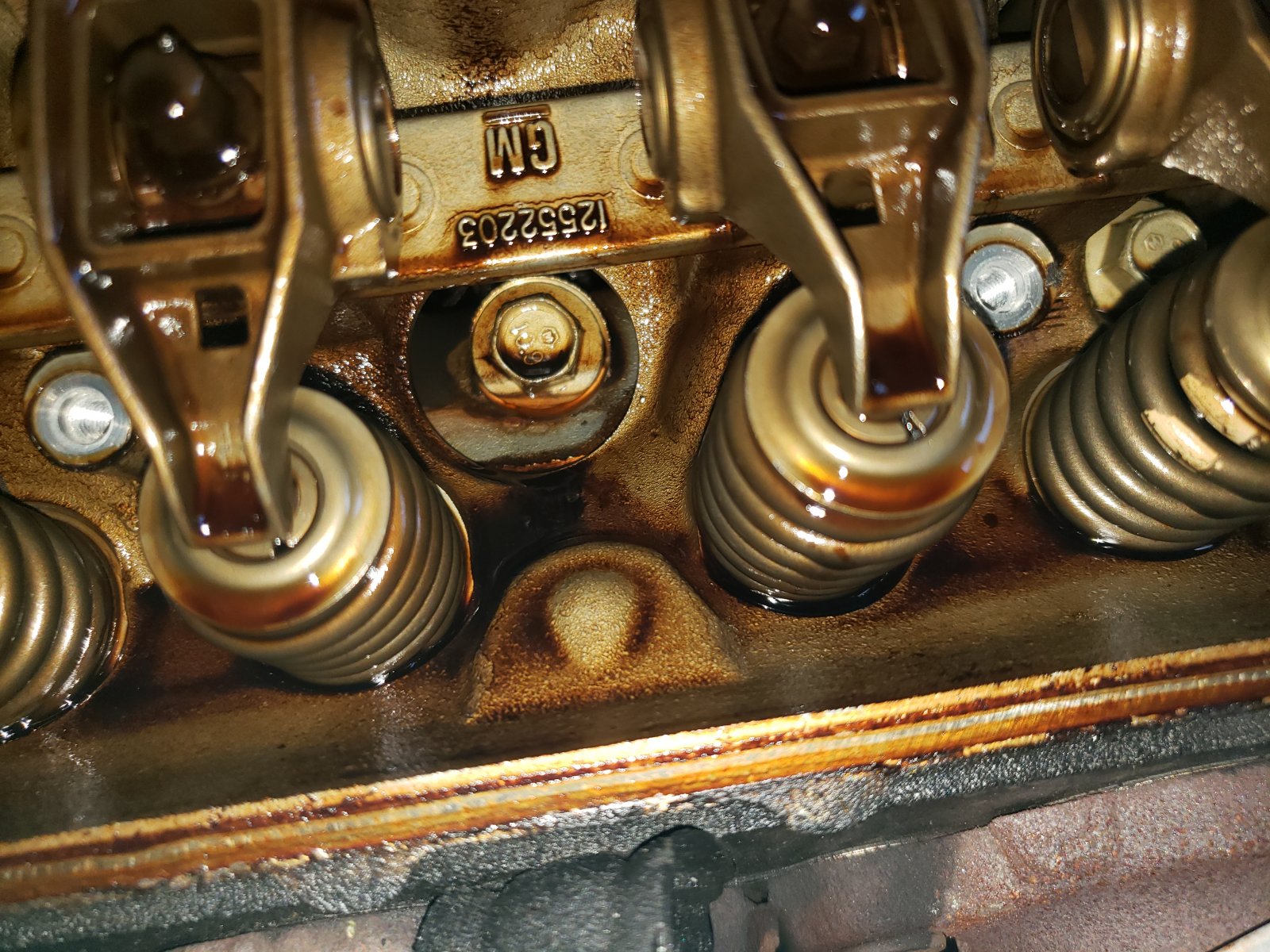

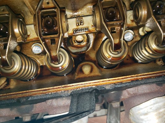

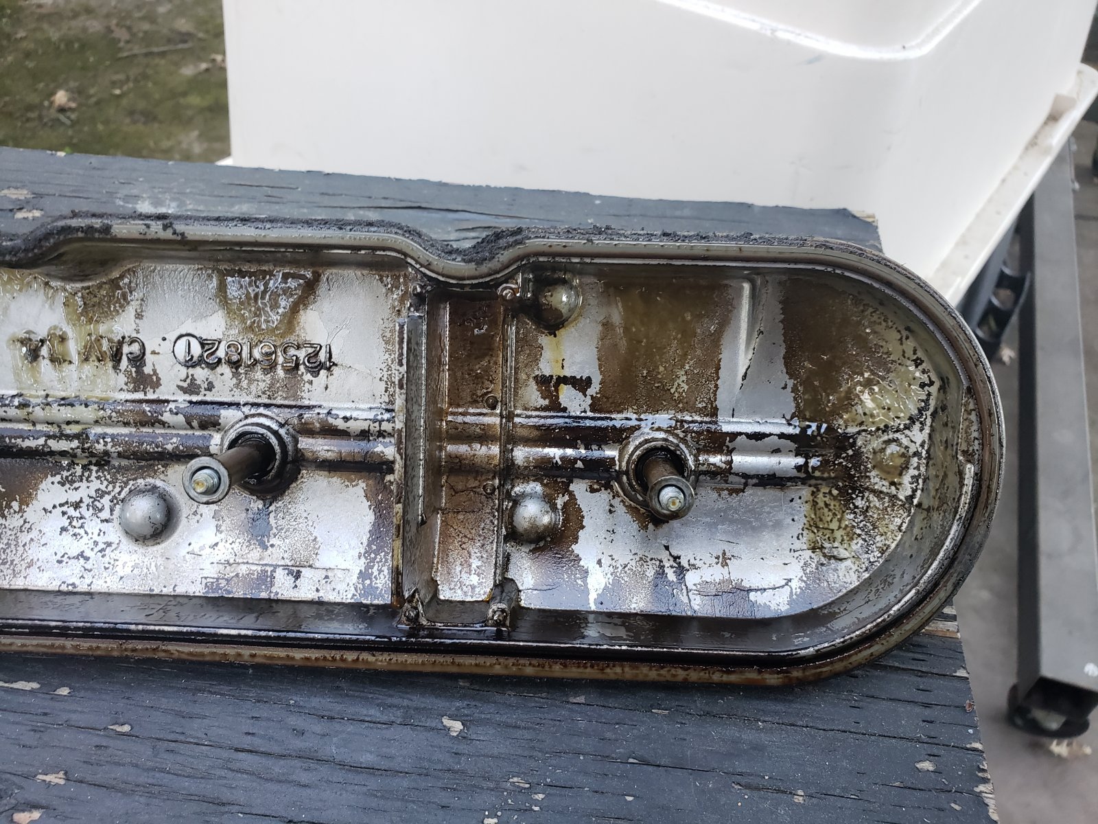

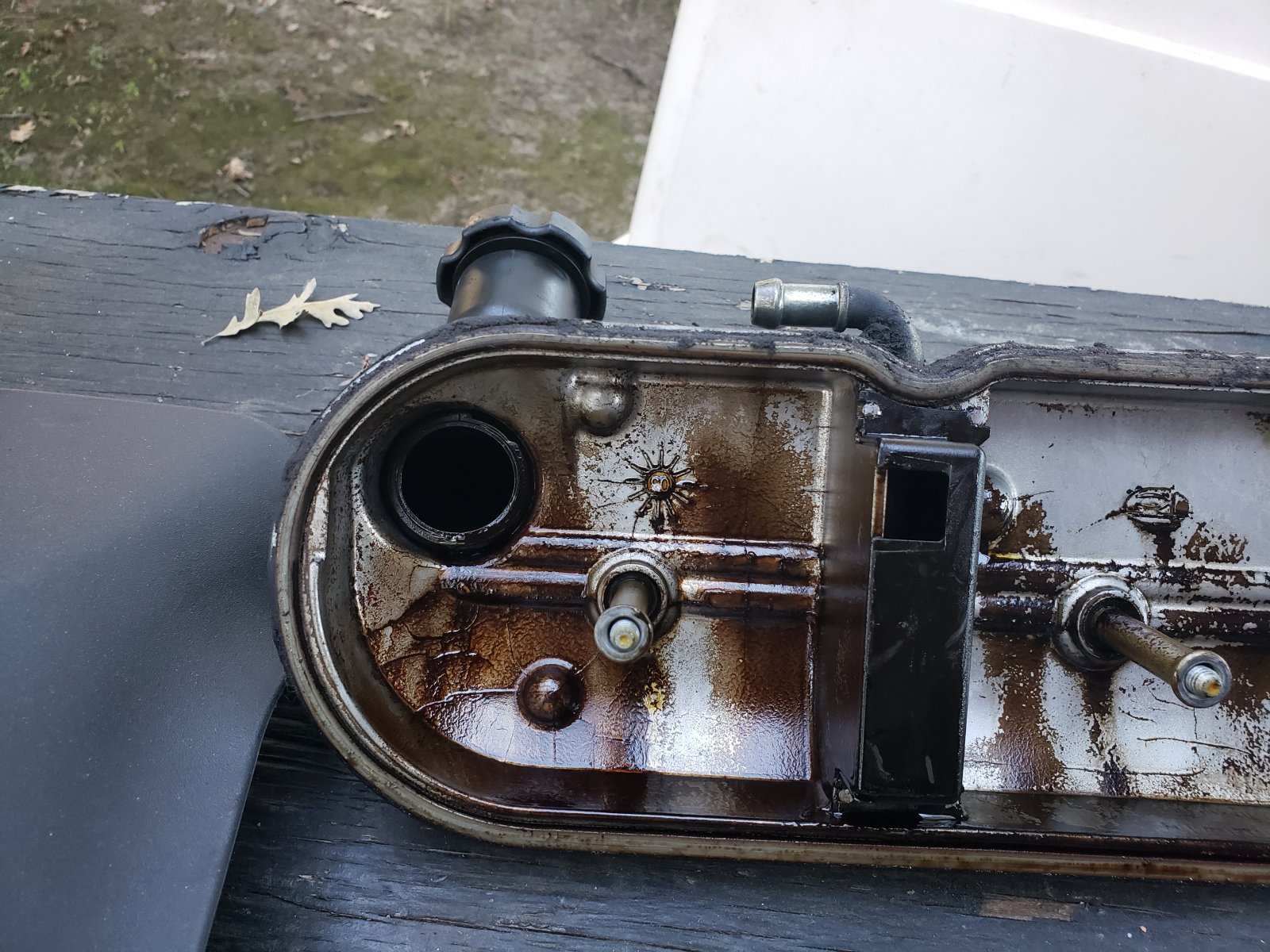

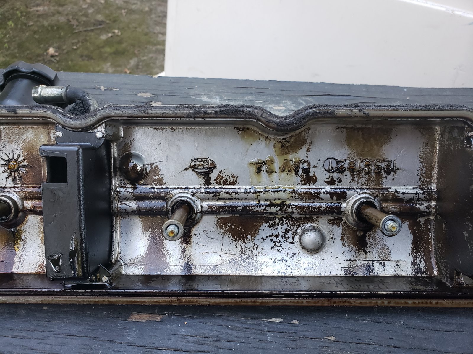

OK Major Update!
See Pics. I just replaced the valve cover 6 months ago and about 2300 miles ago and here is what it looks like. The gunk seems to have built up the cylinder head between the 5th and 3rd cylinder most ( dont have a picture of this )... Any conclusions?

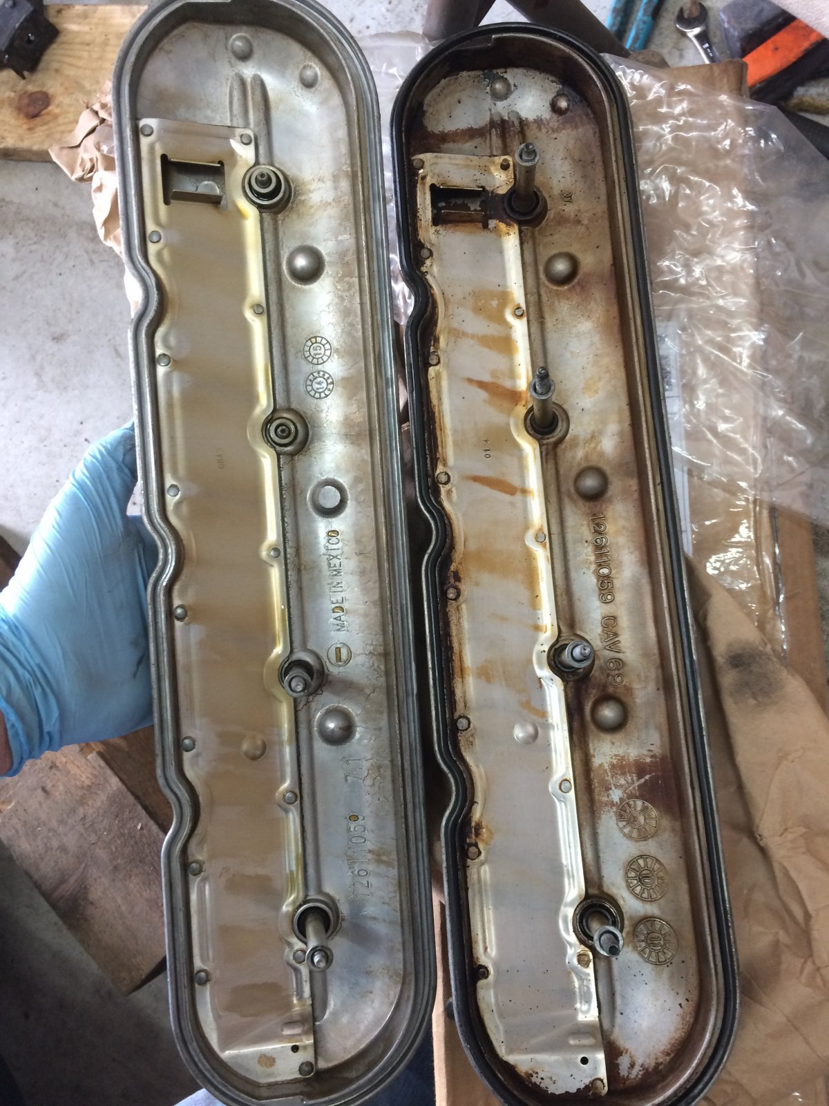

In my amateur opinion, that's definitely water/coolant mixed with oil. When my refurb head cracked, it looked like that as the oil was practically brand new. Get the dye and light and pressurize it and you might spot the leak. Otherwise, just prepare for swapping both heads, again, in my amateur opinion.
This is mine with unknown miles on the oil with the OEM heads.
