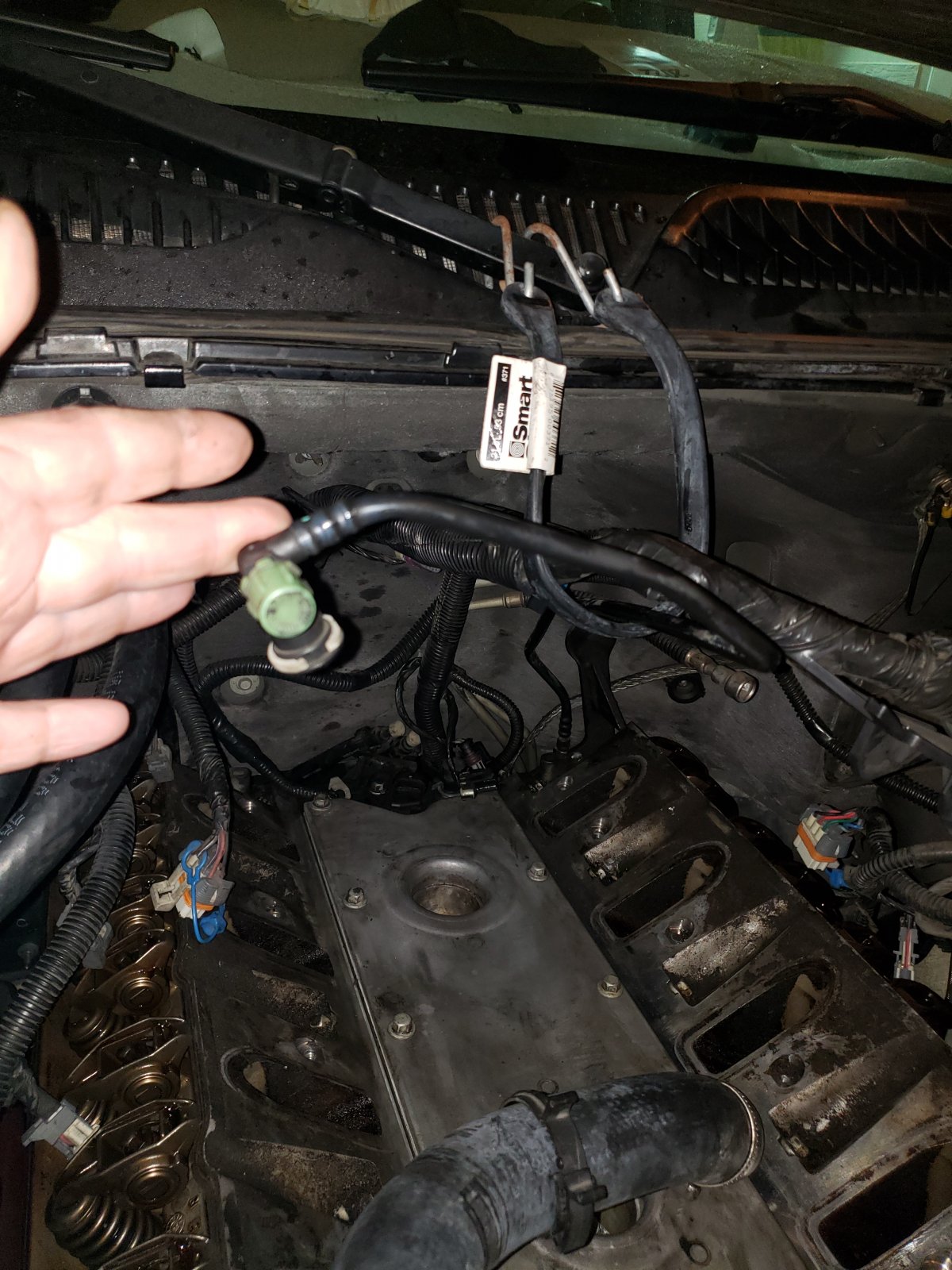

Got it. Sorry Matt I didn't realize it was you. Alright well...Hmmm... LOL I am going to wait for Blackstone. If there is coolant found, I am going to pull the trigger on new heads, valley pan gasket, new knock sensors (one knock sensor is either broke or rust has blocked the grounding to the block and currently it is rewired to trick the system to keep going without the warning lights ), oil sensor while I am in there.

Have you looked under the passenger side cover?
