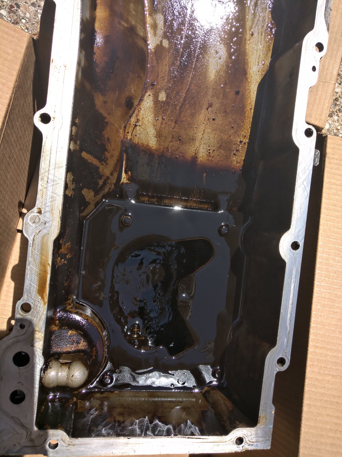

In my amateur opinion, that's definitely water/coolant mixed with oil. When my refurb head cracked, it looked like that as the oil was practically brand new. Get the dye and light and pressurize it and you might spot the leak. Otherwise, just prepare for swapping both heads, again, in my amateur opinion.
This is mine with unknown miles on the oil with the OEM heads.
Same gunk but a darker background. The only reason mine doesn't look like yours is my valve cover is nearly new. I just hope the engine is still in one piece after running partial coolant as oil. Good grief. Not going to bother with any further inspections. 203k miles and I have the 706 Battery heads. It is time to take care of this. Thank you for pics.

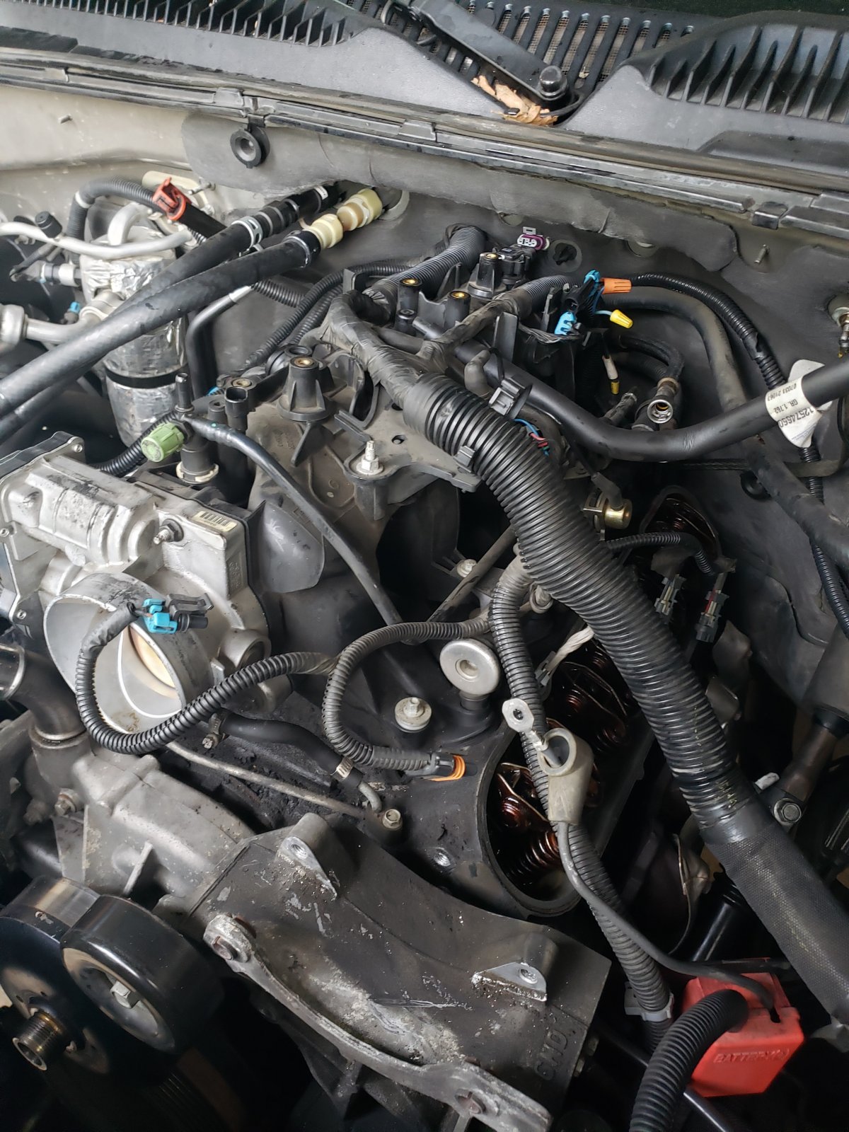

OK Major Update!
See Pics. I just replaced the valve cover 6 months ago and about 2300 miles ago and here is what it looks like. The gunk seems to have built up the cylinder head between the 5th and 3rd cylinder most ( dont have a picture of this )... Any conclusions?
View attachment 362709View attachment 362710
What do the heads and rockers look like? Any real clean spots on them? Pics?

Can we get a good pic of the springs/rockers/etc.? Have you looked at the areas around head bolts, particularly between #3 and #5?

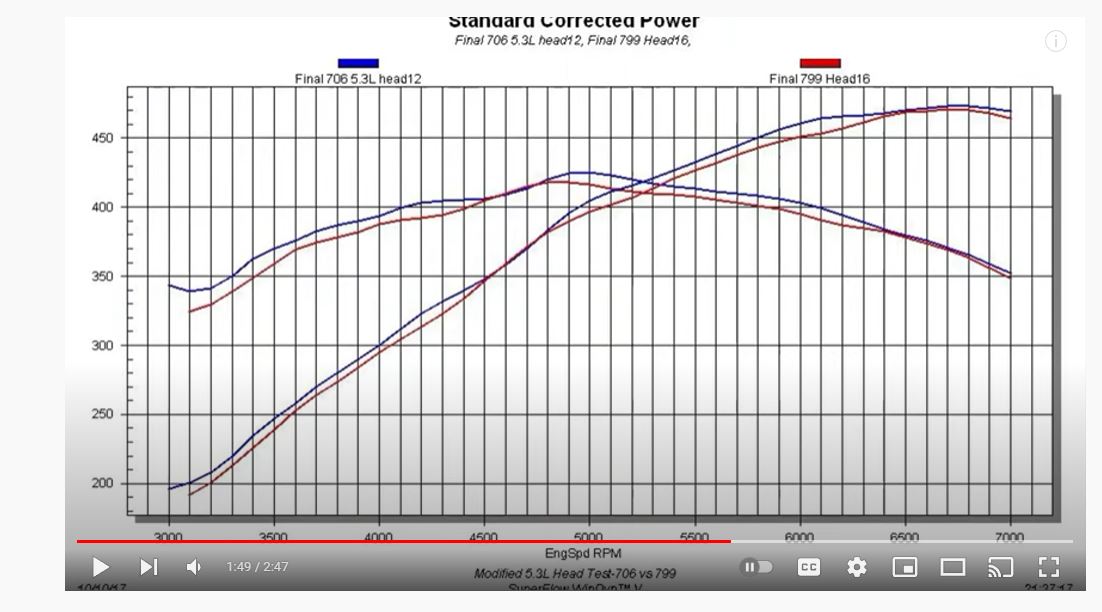

Pending confirmation of a cracked head(s), I'd be weighing my options between those refurbed NuTech heads or finding a set of 799/243s and having them refurbed (cleaned, milled, etc.). We couldn't find non-Castech 706s but found some low-mileage 799s and slapped 'em on as-is. Better flowing head, but a small loss of compression. He wasn't worried about it considering the price. In my area, I could have a set of heads done for about $300. A set of 799/243 go for $300, so it'd be the same cost invested. But, the bump in power would make it the better deal for me. You gotta reward yourself for your troubles, right?
Do the 799 heads require a different head gasket or anything else different. I can get a pretty good deal on a set of these. Will send pics shortly.

I don't see much here. One thing to note before I took this picture earlier today, there was bunch of gunk built up in between 3 and 5.
