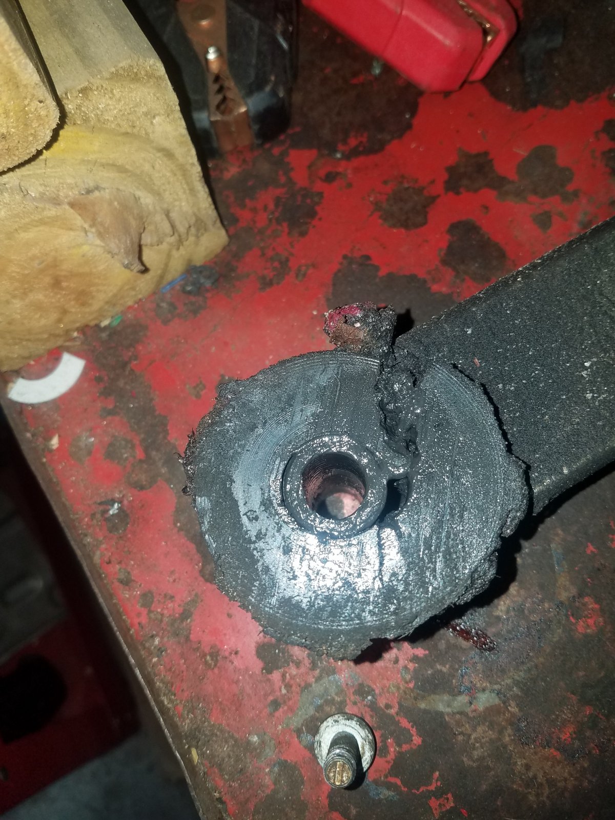

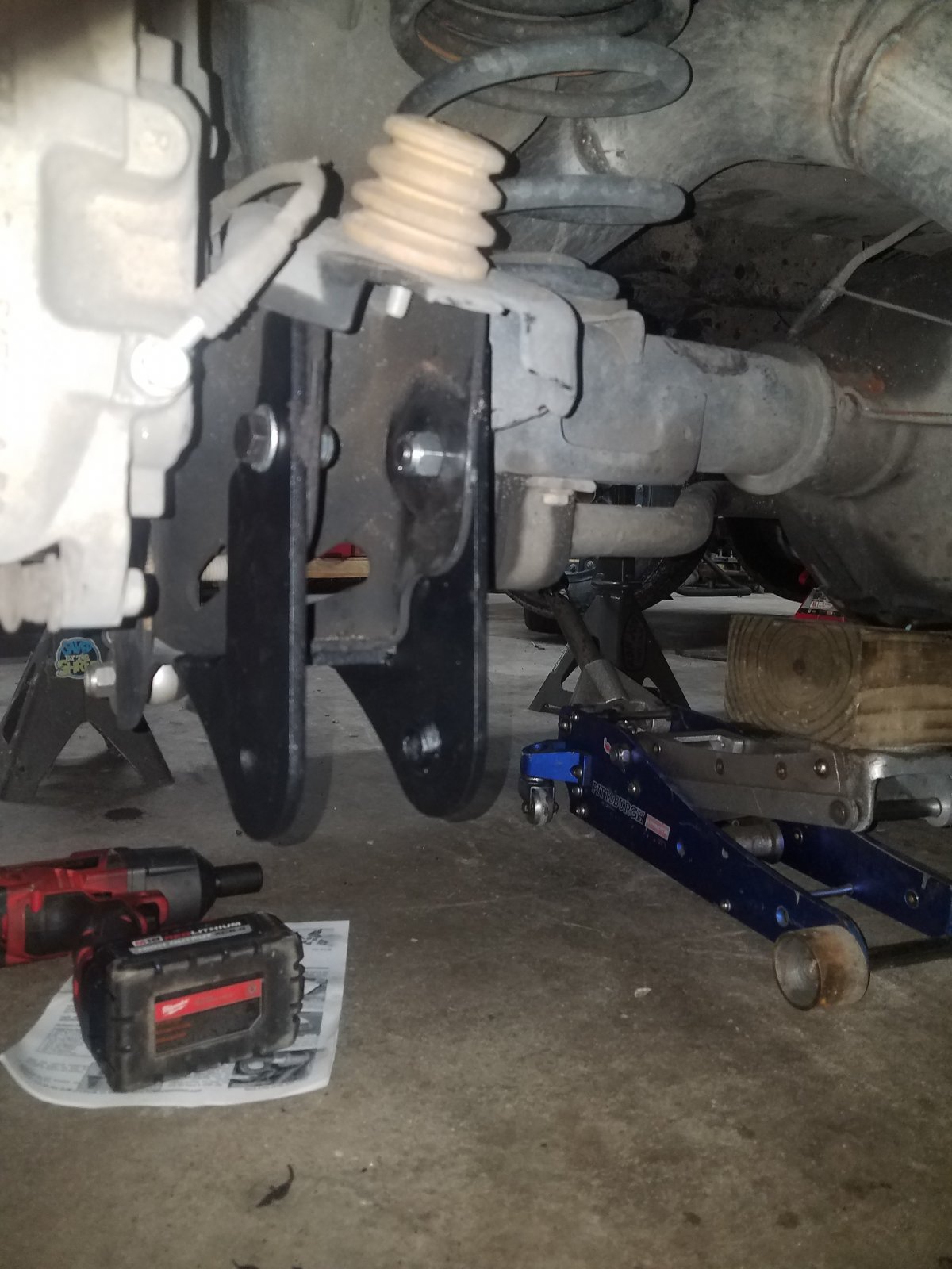

Measured for rear shocks and ride height is at 17.5 with the shock extenders I just added, so the 806s should fit great! Installing the shock extenders was a mofo because they were sorta bent and the holes didn't line up worth a crap. So tis the season to use a Christmas tree and waller them sonsabeachs out!
Noticed the driver side KYB shock is pretty shot but the passenger side was stiffer than a preachers ******.
Also went back to the tiny bump pads which give me nearly 10" of travel from full droop to full bump. Not Baja 1,000 numbers but good for a lowered truck.
