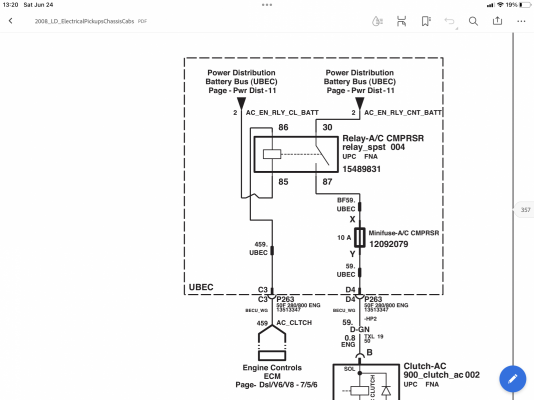

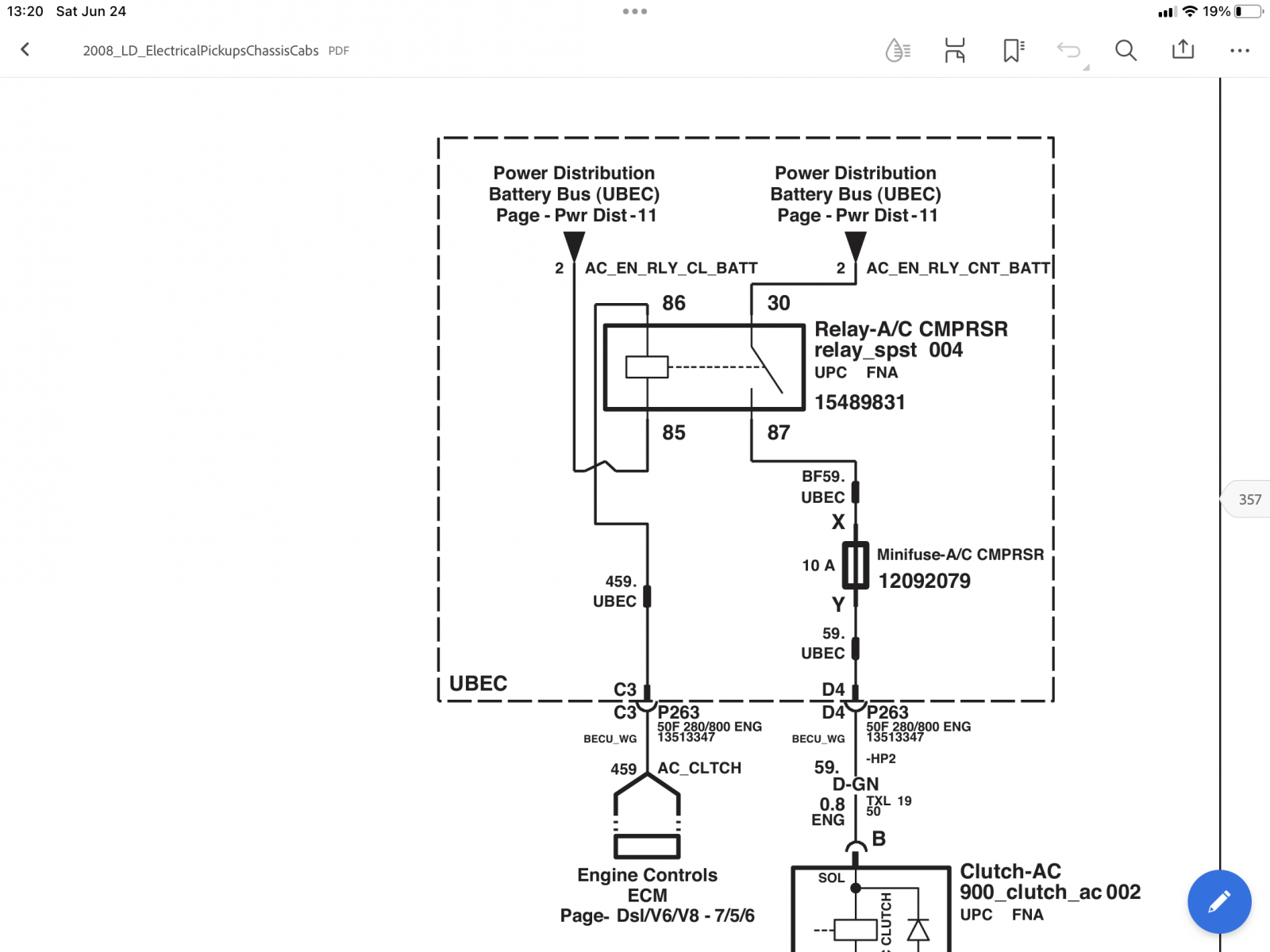

Are you gettig 12v to the compressor plug? That is where you should start. If yes then the coil could be bad. Or the clutch is too worn and the coil cant pull it in because the air gap is too big.
So first find out if you have power at the plug.

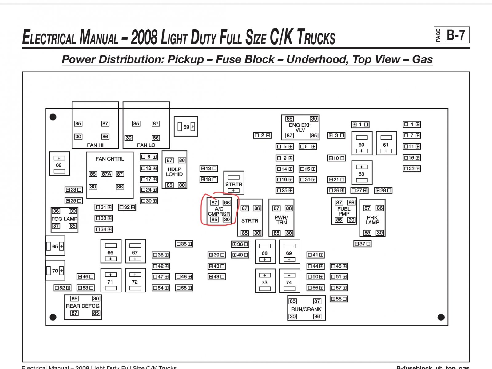

Ok. Power to the clutch is possible.
But as explained, the problem began as a properly working ac.
Then turning off the snowflake button did not stop the cooling.
Then when it did turn off, it would not turn back on. Period.
I first though of controls,swapped relays with the horn and no change. Then checked system pressures., all good.
I hopefully will get to it today to try some tests.
