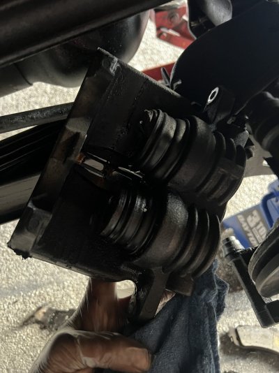

Very logical analysis! The caliper piston in the rear had completely shattered due to depleted brake pads. It release most if not all of the brake fluid. Upon realizing this I replaced the caliper and the presumed amount of brake fluid. All pads are new front and rear.
I did need to bleed each one to be able to pressed the pistons in just in order to be able to set them in place over the brakes pads.
*which I thought was odd being that I’ve never had that experience during a brake change*
Before bleeding each brake the pistons would protrude even after applying pressure to push them inward via c clamp they’ d push themselves back out.
