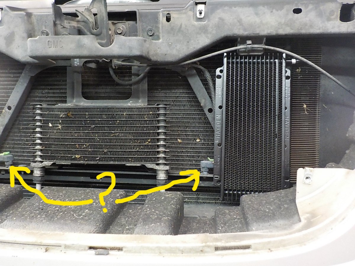

I am also in Florida and my temps are about the same with the stock transmission coolers. Have you cleaned the fins on the condenser or changed grills or... Wait a sec, what are the condition of the baffles, those tar paper like pieces that go on either side of the radiator and one underneath? When these deteriorate and fall away, a lot of air then makes its way around and not through the radiator.
Here's a pic from the internet:
The one to our right is intact and in place. The one on the left has fallen out of place some. Mine were falling apart so I replaced them when we did the bumper cover.

Both of my baffles are flimsy/torn and not doing anything. I think they both are flimsy enough to have fallen down.
But could that be enough to cause it to run too warm? The "fins" on the radiator (new) and trans cooler (new) are clean. The AC condenser looks good too.
If they are not doing what they are supposed to do, yes, the motor will run warmer as too much air is getting around the radiator and not through it to cool.

I'm not convinced they would help for my specific issue. I don't have any cooling issues at highway speeds, which tells me that there is plenty of airflow through the radiator. When at slow speeds and relying on the fans, the fans PULL air through the radiator from inside the fan shroud.....so those baffles aren't doing anything to help with that. The baffles are to direct air through the radiator at speeds where the fans are turned off. They don't do anything at speeds that use the fans for airflow. I don't have any cooling issues then....only at slow speeds and while stopped (idle).

Open baffles could allow engine heat (pushed by the fans) to recirc to the front of the radiator at idle or low speeds. What's to be lost by making them whole again? If nothing else it could disprove my statement above. I'd be curious.
