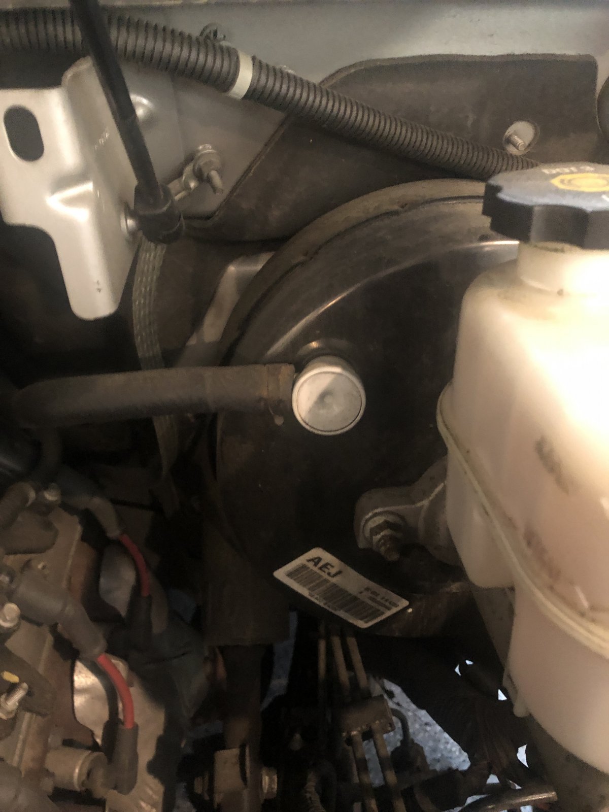

Alright guys after a long process and having to put off the project due to traveling and etc... I finally got it started and running. I do have three things that concern me.
1) Stabilitrak light is still on. Why could this be?
2) p300 engine misfire code. This worries me any reason why I could be getting this misfire? Put new plugs in this morning before start up
3) oil pressure fluctuates. 40 when I rev the engine but drops low when idle. Any opinions? (Posted pics)
