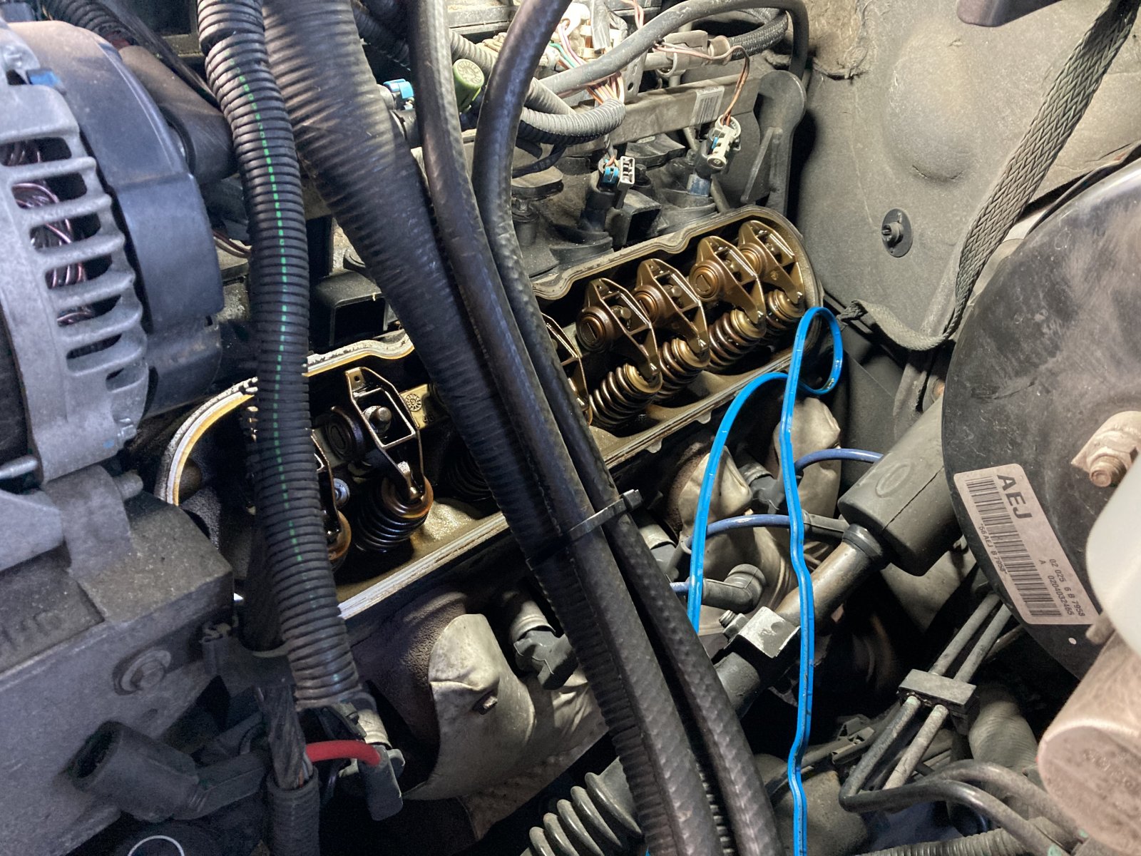

I feel you. I have to do the same thing EVERY year for testing. I pull it out a week prior so it resets. I don't really stress over it though, it is what it is and I am grateful how long it has lasted so far. And she is VERY clean inside regarding sludge for this mileage:
